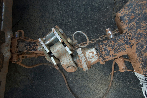

The lock N Roll has an issue with bending in a certain situation. IIRC, its when backing up, at an angle, uphill... or something like that. It’s not very common, but I’ve seen a few instances.
58504
Good to know. Thanks.
Hard to tell from the picture but that appears to be a pretty beefy trailer too. But something that still needs to be kept in mind. Lock N Roll did mention about their product being improved. I wonder if this is why?
Probably... it was a few years ago that I looked into it and saw them getting bent.
