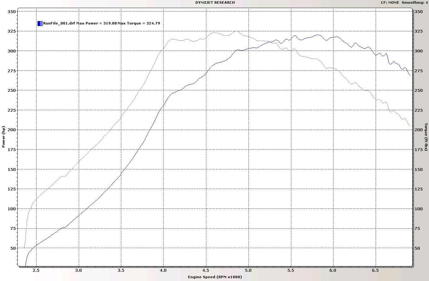

as far as turbos making torque at low rpm... sure, it may not FEEL like they make any torque until 4k, because the punch in the back comes in so strong at that point. that doesnt mean they are weak down low, though.
for example... the stock 1.8 in my escort makes ~100 ft lbs to the ground in stock form at 4500rpm or so. now with the turbo, its making that much torque by 3100, and over three times that by the torque peak - which remains at approximately the same RPM. if we started the dyno pull at a lower RPM then i'd probably see some even higher numbers down low with a little more load/time to spool the turbo
http://i38.photobucket.com/albums/e101/therieldeal/95 EGTR/320whp325wtq.gif
you guys have talked me into it, i think the 2.3t is going to work just fine for towing. i'll just stick to a small-ish turbo and make sure i have adequate cooling.
