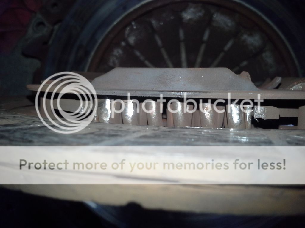

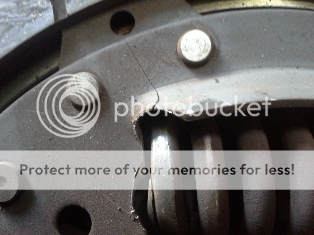

Last week I had to replace my clutch. That is the trip that I think did this damage.

The 4.0 will do the work. I think, don't know, but I THINK the load I pulled to break my clutch like that was 3K lbs or more. I also have the truck set up to do heavy work. I have the M5OD and the 31 spline rear. I am still thankful that my clutch disc seems to be the only thing that broke.
Yeah I have the bigger heavy duty 4.0 clutch I put in when I did the 4.0 swap to lessen the strain on the fm145, because I already know its not really ment to be behind the 4.0. But no problems so far
Dude, read through my build thread. Those pictures are of a standard duty 4.0 clutch. The 4.0 will toast a 2.9 clutch without even thinking about it.
