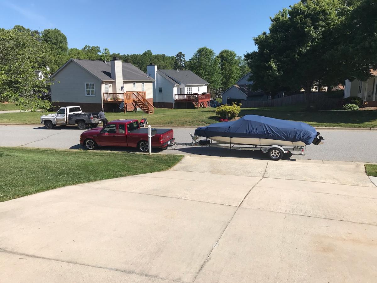

2011 4.0, auto, 2WD, 3:55 gear. Boat and trailer about 3500 lbs. No problem.
