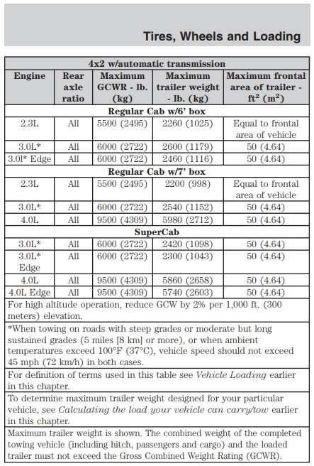

Depending on configuration, some Rangers went as high as nearly 6000 pounds. As an example, this is a page from the 2005 owners manual...
29766
Those numbers aren't really the tow rating, they are what it can tow with zero load and in magic conditions. You still have to go by the gcwr minus vehicle weight, passengers and cargo to get tow load. But yea its probably around 4.5-5k when you sort all that out not 3k. But a 05 is also alot stronger than a 91.
Those numbers are quite literally the official tow rating, straight from the manufacturer. Yes, you need to adjust them based on payload (as referenced explicitly in the image I shared) but that applies to every towing situation and you're just trying to move the goalposts.

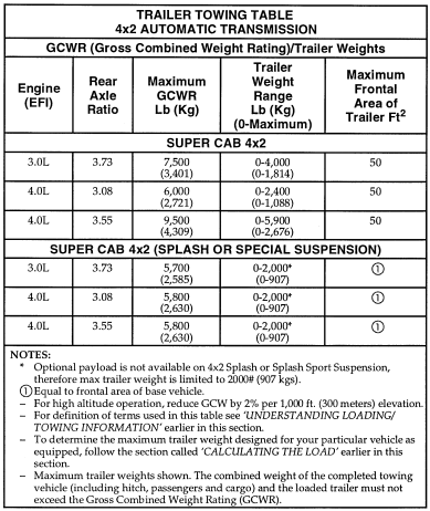

As to 2005? I went there because you referenced the OHC engine in the previous post. 1991 isn't available from Ford's website, but 1996 still represents the OHV 4.0:
