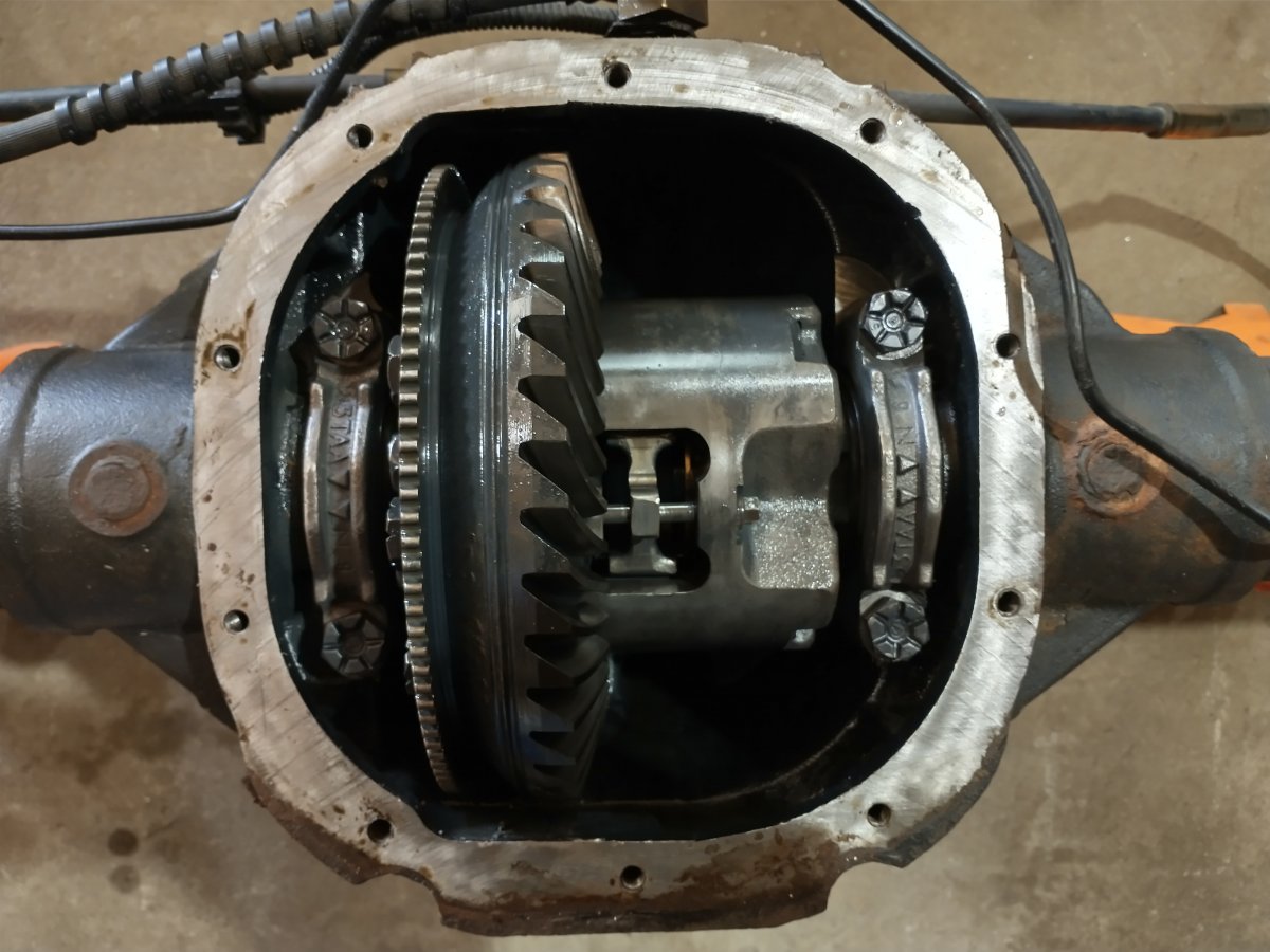

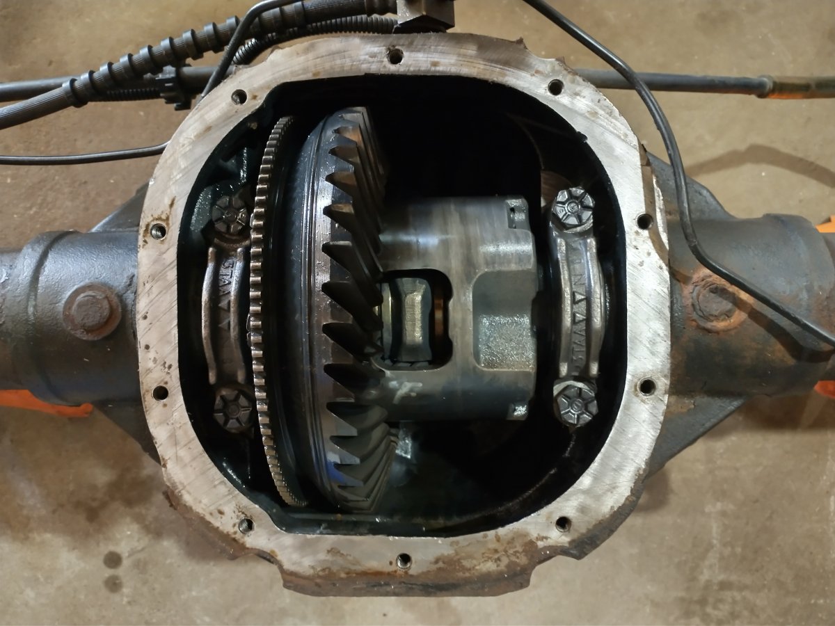

I recently picked up a Torsen rear axle at a salvage yard from a 2004 FX4 level 2 Ranger. I believe that the Torsen rear ends have 3.25" diameter axle tubes while the non-Torsen rear ends have 2.75" diameter axle tubes. Here are some pictures of the insides of the Torsen differential if it helps, and a link for the correct size wheel bearings and seals to use if you want to replace them.

The 31 spline axles in the FX4 Level 2 Rangers do indeed have bigger axle tubes than the 28 spline models. The exception is the axles in the 2010 and 2011 Rangers. Those 28 spline axles have the bigger tube like the 31 spline axles. The execution is a little different though. I think more due to the change to disc brakes than anything else.
