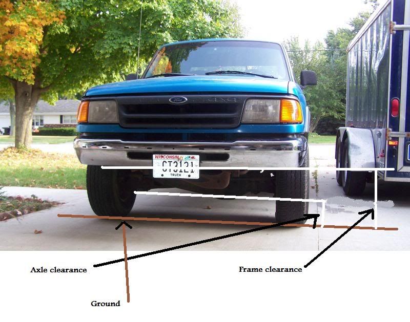

perhaps a visual aid will help.
the idea of lifting (no matter what method) is to get bigger tires on your truck to increase axle clearance.
-suspension and body lifts no not increase axle clearance.
-suspension lifts increase frame and body clearance.
- body lifts increase body clearance.
What is so confusing about this idea? You don't ever change your axle to ground clearance unless you change tire size. The idea of suspension lifts is to make it so you CAN change tire size to gain axle to ground clearance, as well as suspension performance. Body lifts let you put on bigger, taller tires which means more axle to ground clearance.
