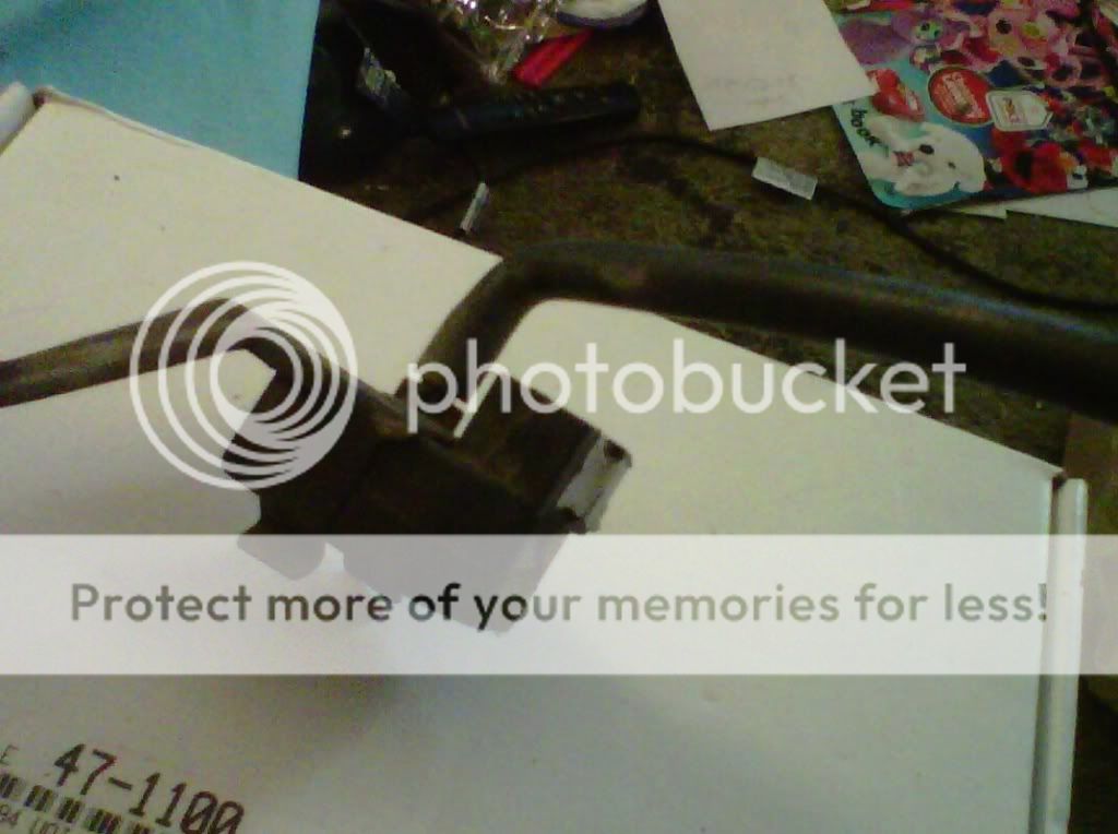

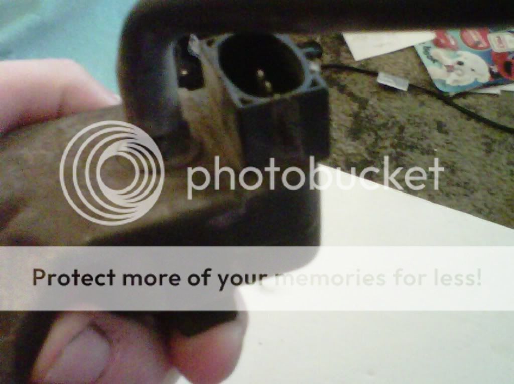

Well i am getting close to getting my truck all put back together, but i have run into a misc sensor.
Here is a pic

Sensor is for EGR flow.
Figured it out, it bolts on top of the throttle linkage.
