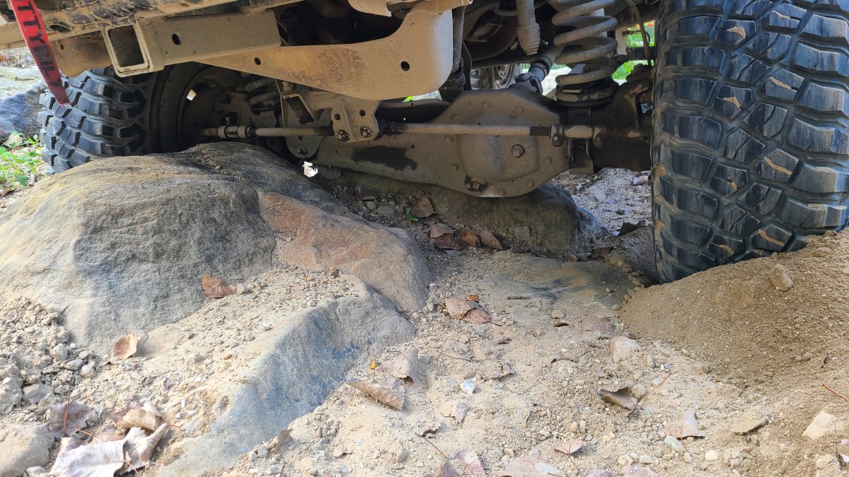

Being high centered is when you get hung up on something bigger than your ground clearance. So the wheels are off the ground and you're stuck. It seems to be one of my favorite tricks at our annual roundups. For example;
YIKES! I was thinking early on that where possible you always want the tires on the highest spots otherwise this happens. It probably went great over the front but when the rears went where they did then you're screwed. Looks hung up so probably couldn't back out.
Maybe independent rear susp would help?
You're right. I needed to have some wheels on the rocks. But it slipped off the line I was trying to travel. It happens.
Being high centered isn’t a big deal if you have good skid plates to protect the important bits (I don’t yet).
