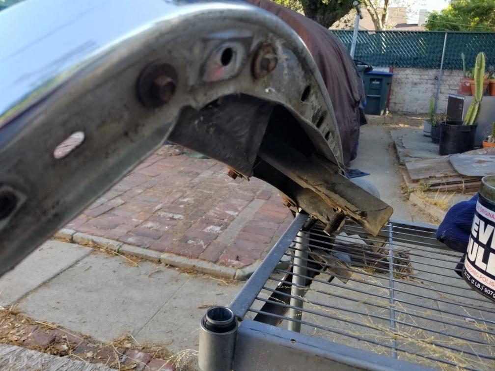

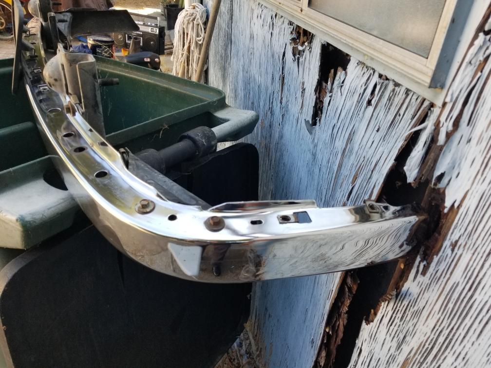

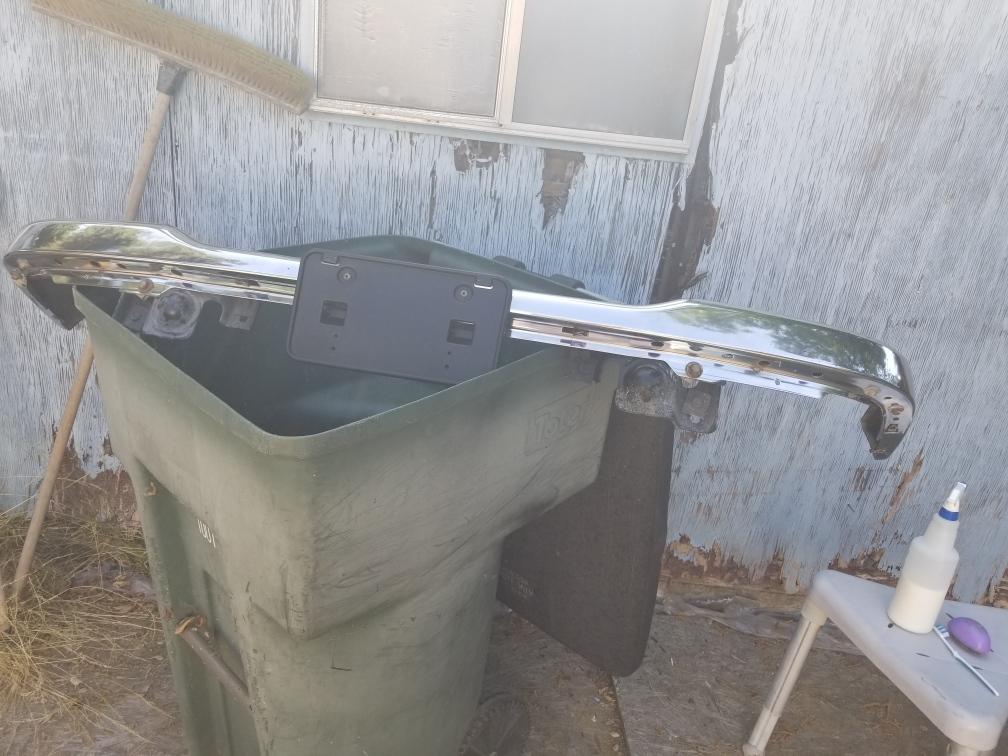

This filthy & rusty but undented front bumper was a whopping $36.95, no core necessary and it's the factory part ~ I try hard to avoid Chinesium whenever I can .
We're having a heat wave right now, it hits 90 + * F by 09:00 so I was out in the shade before the sun came up doing this :
Tinkering Endlessly (or, why I love junkyards)

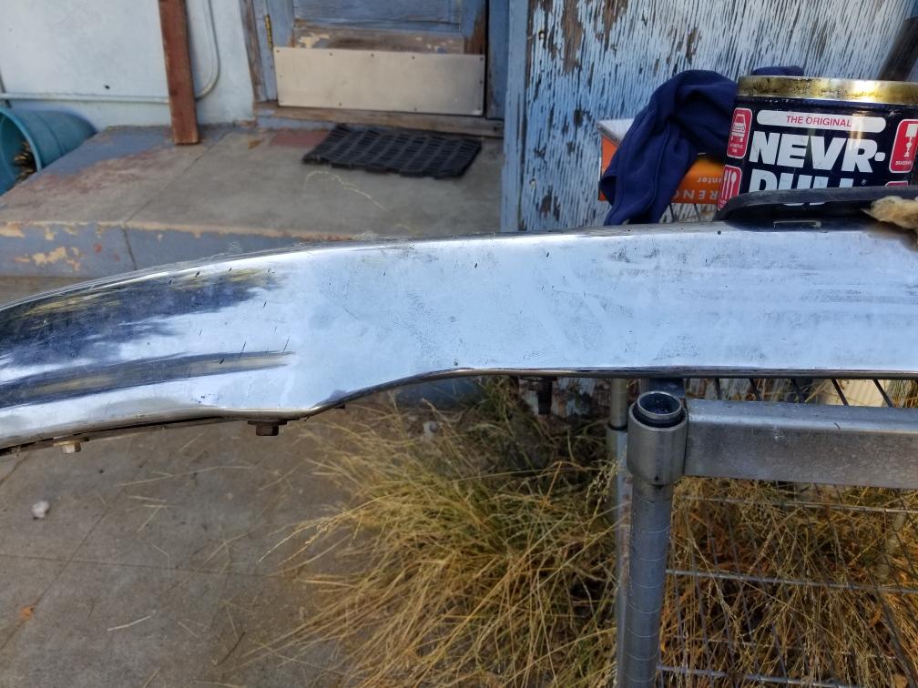

Sorry about the sun glare, this was when I quit :
Next will be to test fit the off color lower valance and fog/driving lamps, make sure everything lines up, ten maybe Ill ave the valance painted to match the truck .
Not sure if I should go red to match the rest or shiny black to highlight the chrome .
More to come, this Fleet Spec. didn't have the tow hoops either so I want to go back and buy a pair of those too .

my truck is an edge so its fleet spec also but it comes with hthe colored bumpers and fog lights. i say color it red to match because it looks great that way. see my pic by my name
Thanx Super J. ! .
Why I'm on the fence ~ I like the different color lower valance and am thinking towards gloss black at this moment .

It is ~ I worked on it and ten had to leave suddenly, last night I moved it for more work space and really like it ~ it weighs quite a bit .
We're having over 100* F temps but I hope to perhaps test fit it today .

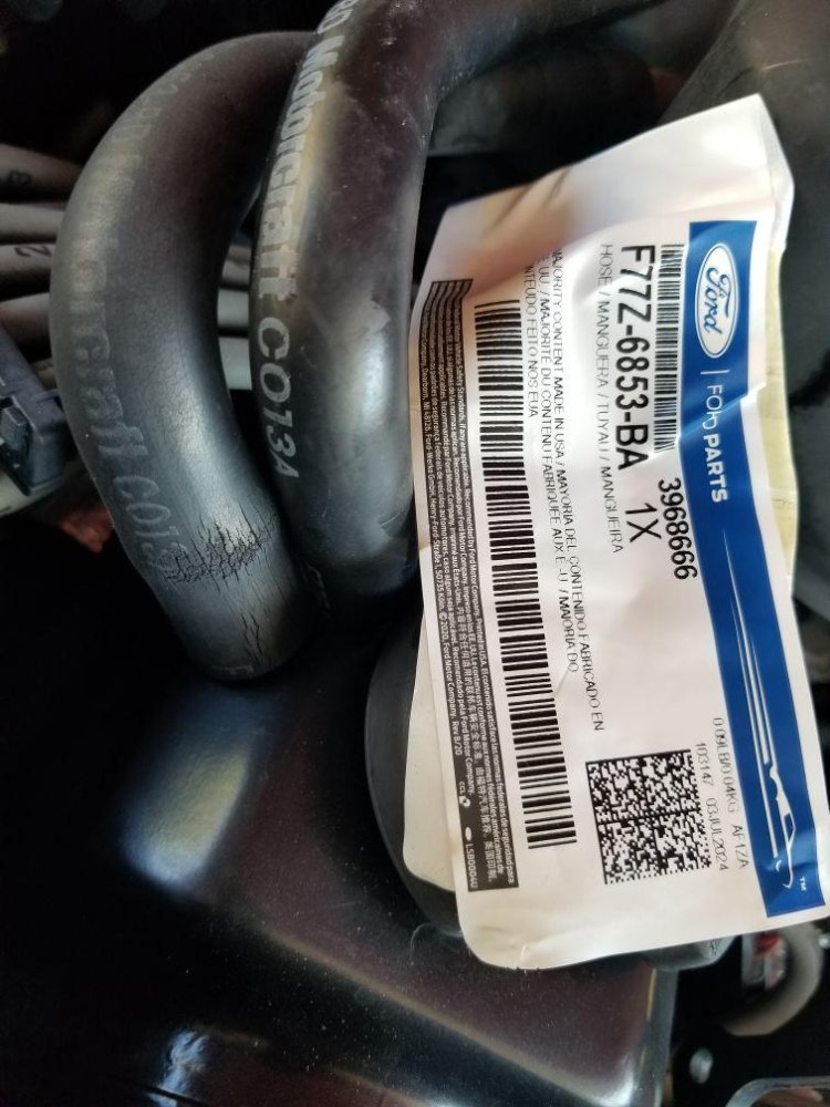

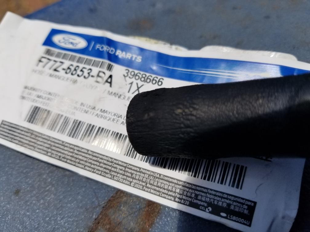

Looking at the rockerbox vapor vent hose showed it to be perished and shot through with cracks, I was able to order one affordably from the local Ford dealer :
A closer if unfocused picture of the perished end :

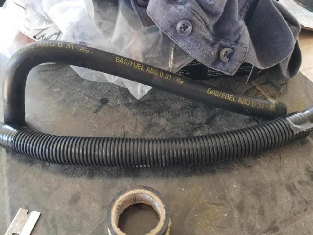

Interestingly Ford used that corrugated black plastic stuff over most of the perished hoses so only the ends were rotted :

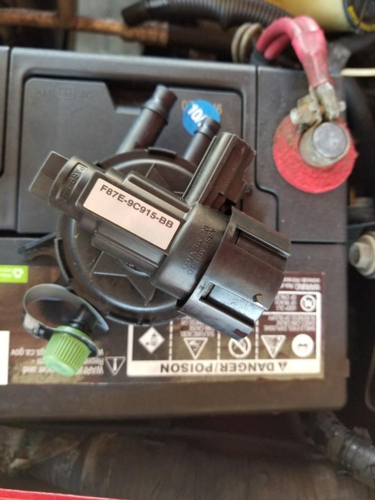

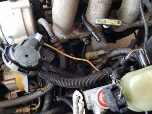

This rockerbox hose was an easy job so I looked at the the fuel tank vapor recovery valve's hoses, the one leading to the engine disintegrated in my hand and had already been replaced . The other one down under the valve where I couldn't see/touch it was also dry and fluffy at both ends ~ I removed the valve proper and discovered it was filthy and greasy underneath where my cleaning hadn't quite reached . after removal and careful cleaning it's ready for re installation :
Interestingly, it's made by SIMMONS, a well known German maker of valves and things for Mercedes and the rest . this one was made in Mexico, increasingly the go - to country for good quality parts and vehicles .
Here's a picture of the hidden bad hose between the valve and tank vent pipe after cleaning :
You'll notice I cleaned the hard plastic corrugated cover stuff and re installed and taped it up just as Ford did in St. Luis 23 years ago . both ends of the original (upper in the picture) hose are clearly perished and no longer sealing, hence _maybe_ the source of the vacuum leak (?) .
Almost finished :
The hoses are reconnected and I was about to tuck the valve/solenoid to it's bracket underneath the master cylinder, I decided to do some more cleaning and de greasing, it's *much* cleaner and nicer now, you'll notice I spent some time cleaning the master cylinder too .
To the far right you'll see a vertical skinny section of the black plastic corrugated stuff, my last junkyard foray was fruitful as I grabbed this exact piece and installed it over the yellowed horizontal vacuum control pipe you can see . I'm pretty sure this Nylon vacuum pipe was _white_ when new, I didn't think to grab that from the junked truck, maybe next time . for now it's cleaned and covered and out of sight as well as insulated from the engine's heat and vapors .
