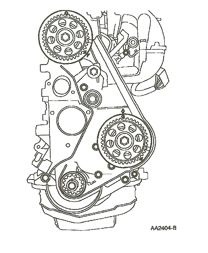

Replaced timing belt, running but lacks power. Missing both halves of the timing cover, so no timing marks to reference. Any help would be great.
Before retiming check compression, 160 to 170psi would be expected
Lack of power from timing belt being off by a tooth or 2 is because of lower compression.
Timing marks
2.3l crank shaft has a woodruff key it would be point up at 90deg to oil pan surface, 2.3l sits at an angle in the engine bay, so oil pan surface isn't "level"
AUX gear mark would be at 12:00
CAM gear mark is at about 4:00, there a mark on engine that you line it up with
Drawing here: https://motogurumag.com/i/ford-23l-...auxiliary-shaft-sprockets-remover-khFEoXi.png

A lot of good info if it only had those parts. Has dual plugs and coil paks. The scale at the crank is gone with the timing cover. The oil consumption came with replacing the timing belt, why I believe it's off just a bit was hoping someone might have a clear picture of one in correct time with the covers off. Didn't take the bolt out of the cam so no leak there. Have never taken off the crank pulley always worked the belt past it.
If you can see the keyway in the nose of the crankshaft(remove the outer pulley?) and the cam & aux shaft sprockets, you can line up the cam timing. The key should be as 12:00, the cam triangle at the pointer(about 4:00), and the aux shaft at... I dunno, sorry. I think there is a mark on the edge of the sprocket that should line up with a pointer/mark on the face of the engine. Search here for proper instructions. I'm trying to remember if the keyway went all the way to the tip of the crankshaft nose. You'd have to remove the bolt to gain visual access, but not necessarily the pulley/damper.

The dot on the crank sprocket dot is not vertical, it points to some sensor I think? Anyways, just make sure the crank keyway is straight up.
You Cam Position Sensor is on the lower sprocket, along with your oil pump. So timing of this gear is also critical, it is not just an idler. I made that mistake with mine, it ran worse and worse for about 20,000 miles, had it apart like 4 times, finally after the engine started trying to escape from under the hood under full throttle did I finally realize there were two different marks on the gear under all the grime, I had been lining it up with the wrong mark (triangle). The actual camshaft (top gear) is Triangle to Triangle, bottom right gear is Diamond to Diamond. Still driving that engine, but power is nowhere near what it was.
It looks like if you match the gears up with the same orientation to eachother you should be good. I believe the camshaft is also keyway straight up, but I would like someone else to confirm that.
