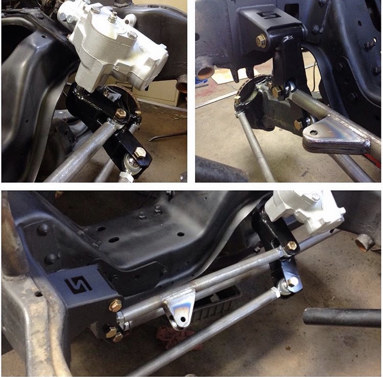

My steering setup has been working very well; I think going with the bronze bushings and steering box sector shaft as the idler arm was a good idea.
However, if you want the steering to work even better, I would recommend going with a swing style or cross over style setup, where the steering linkages are directly in line with the axle pivot points. Mine are a bit shorter, and as a result you get some toe change at full droop/compression. I did make the driver and passenger links' lengths match their respective beam lengths; the drivers' side beam is a bit longer, so I made that link a bit longer as well. I don't recall the measurements, but I kept the driver to passenger length ratio the same so that each side would get equal toe changes during the suspension cycle.
Are you planning on any lift? I have about 5" and am using factory XJ pitman arms(on both the idler and steering gear) and 1" offset tie rod ends, and my steering angles are quite flat, but not perfect. Without any lift, I think you'll need the center link to sit a few inches higher than mine.
As of now, my total lift on the front end is Moog heavy duty coil springs. They did let me fit 31s, though.
I really don't want to lift any more if I can avoid it, but if I *absolutely* need to, I will.
Any photos of an example swing style or cross over style setup? Or reading material? Not too familiar with either; all of my prior lift/mild offroad experience was with Jeep XJ. All I've read so far was the writeup on yours, on some oddball one-off Explorer, and this:
Genuinely curious about this one. I've been picking the brains of quite a few of you on this one pretty hard; apologies for being a bit of a slow learner. ??
Should note: I am still searching for a factory 'high rider' setup (aren't we all?), and would absolutely lift to that level, but no more.
