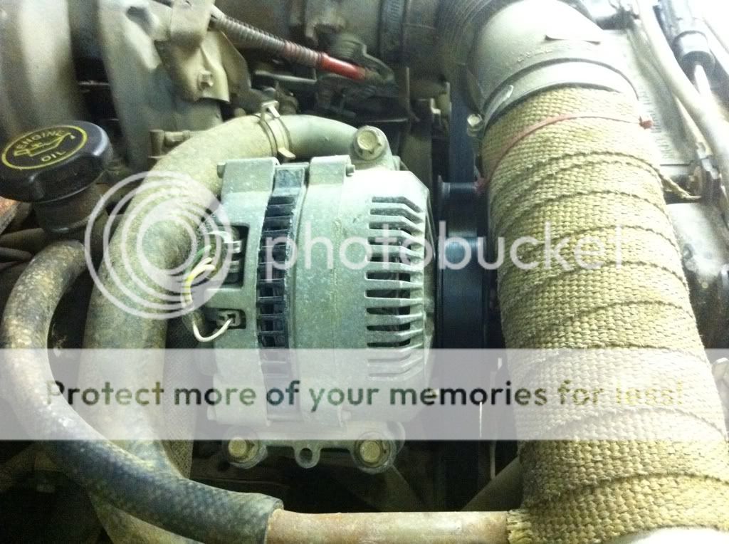

swapped in a 130a alt i picked up at the yard saturday, was off a 90ish f250 with a non turbo 7.3 it had the correct bolt pattern 6 rib pulley and the right connections so it dropped right in, took all of 5 minutes.
the slo-vo build thread...

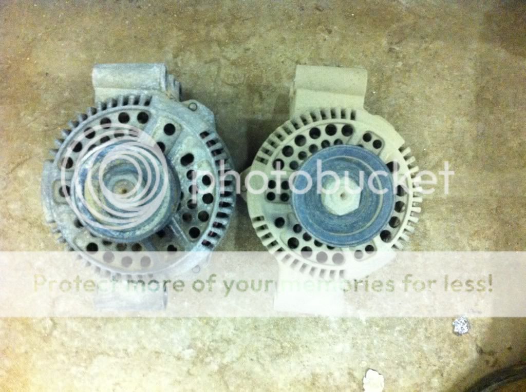

130 on left and stock 95 on right...
Looks good. I need to find me one of those.
That's a powerstroke altenator (95+) as the older IDI 7.3L's have a completely different bolt pattern and are V-ribs...
