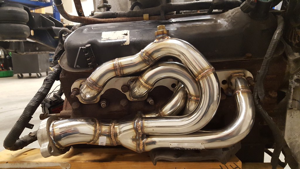

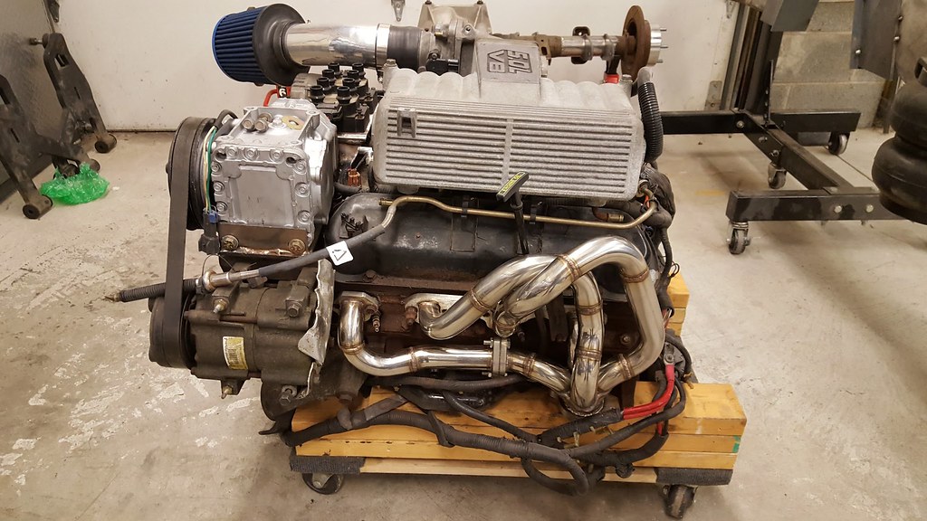

ATX thanks for posting pics. The Tri-Y's look great in there!

Wish this try-y's would fit the 98 and up...

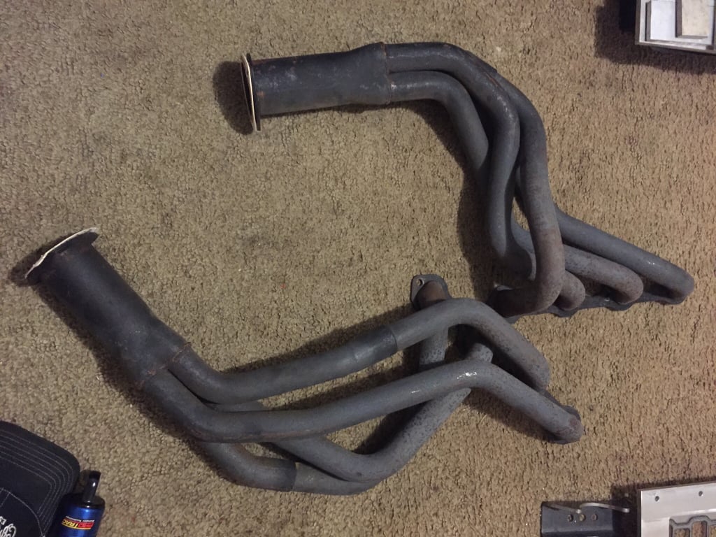

If anybody has some old foxbody long tubes for cheap I'd buy them and post pics of what I have to do to make them fit. I'm going to buy some either way I just hate the idea of buying brand new headers just to possibly cut them up
just picked these up for $60. Passenger side is more than likely gonna need some tubes moved around. Luckily, 3 out of the 4 tubes slip out. But driver side appears very close to fitting as is, won't know till the motors in the truck. But the thing to keep in mind is my steering shaft is moved way over torwards the shock tower on an edge frame. And it's getting a 351w so the motor has to sit a tad bit higher for steering rack to oil pan clearance. In a few weeks when the motor is completely bolted and sealed up and the trucks back on the tires I'll try and update.
This is gonna be interesting, can't wait to see how close they are to fitting for you. Please do keep us updated on the project.
