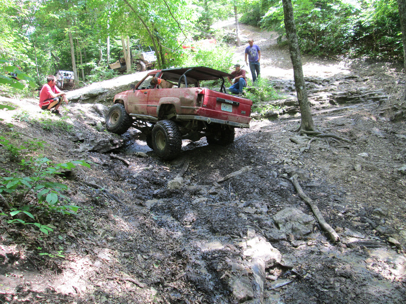

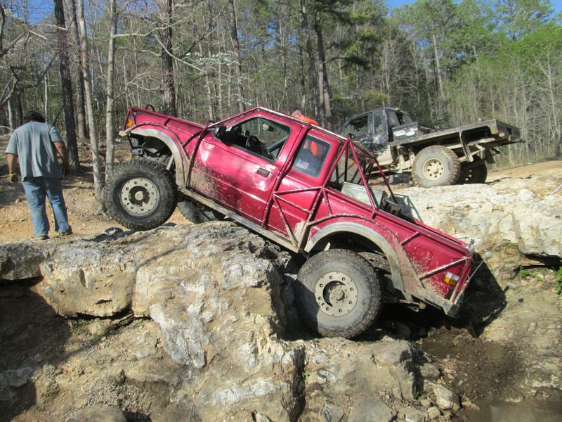

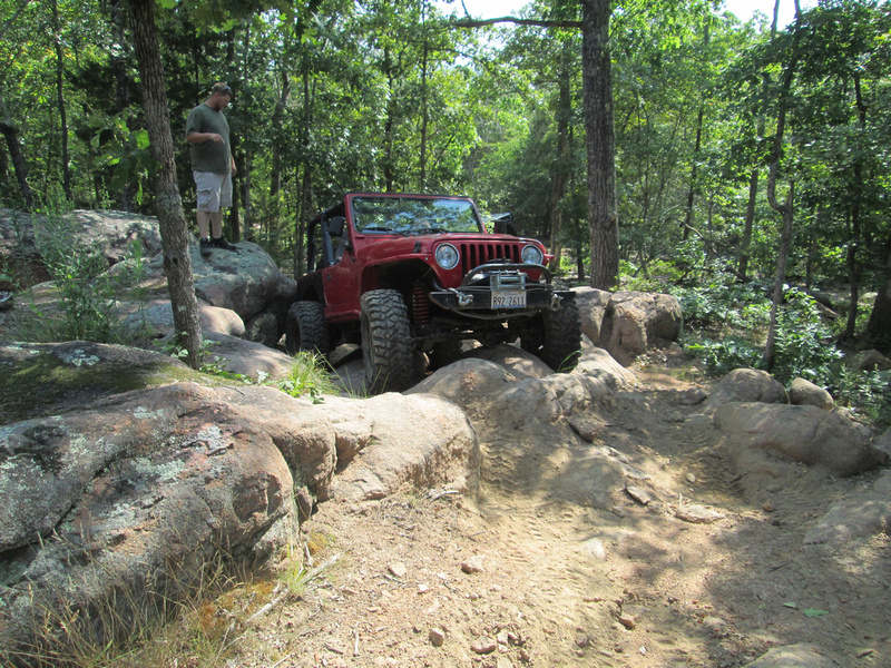

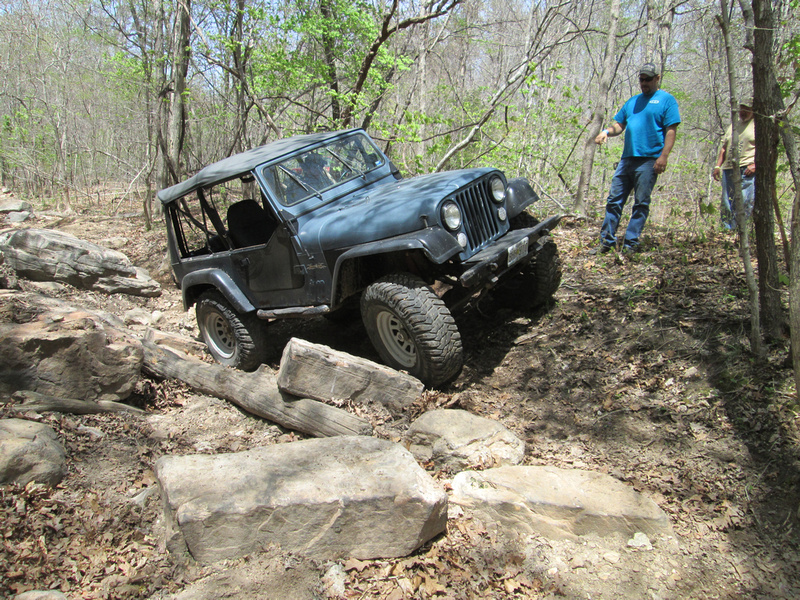

24th Off Road Trip – SIJA Jeep Jam at Flat Nasty Off Road 5-3-14
Started out the day with some good grease:

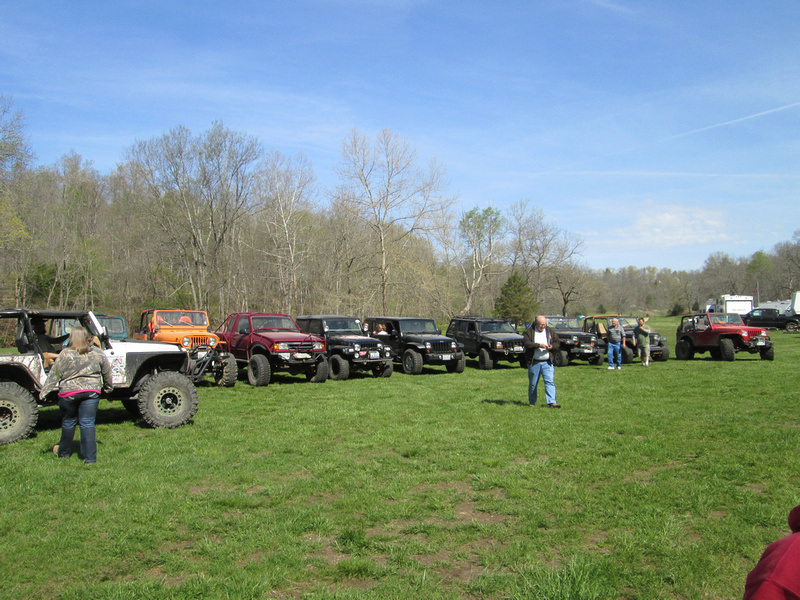

A good chunk of the group (one of these things is not like the others):

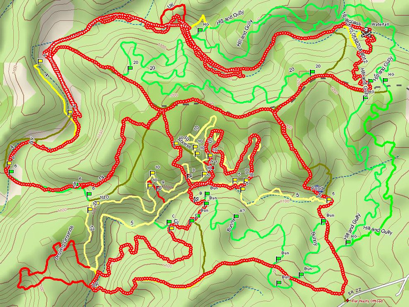

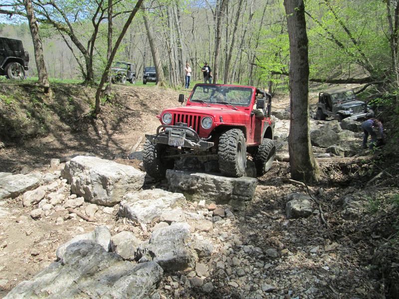

We covered a hair over 11 miles in the park. Most of our time was spent on 18 and 14, with some wandering around in the afternoon:
Random photos from the day:

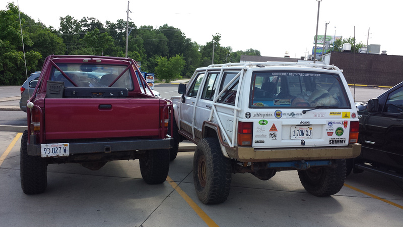

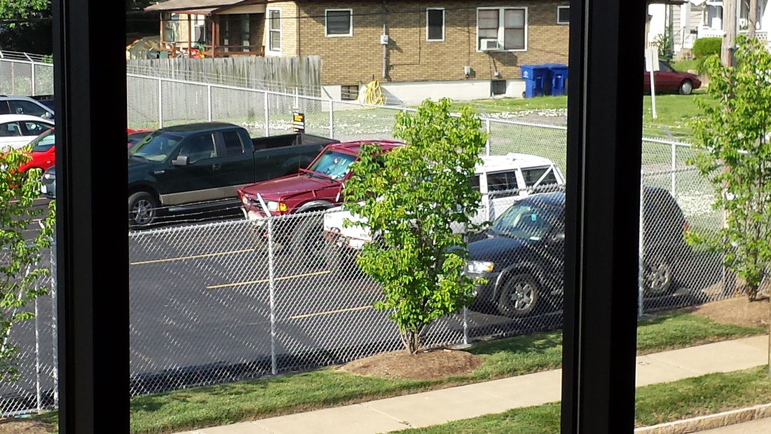

Loaded up the truck and went to work on Friday, patiently waiting for the bell to ring to head South:
We had to make a quick stop in Rolla for some grub and check out the XJ’s steering. It turned out that the ram for the hydro assist had worked itself loose causing it to dart around some. A quick fix and we were back on the road:

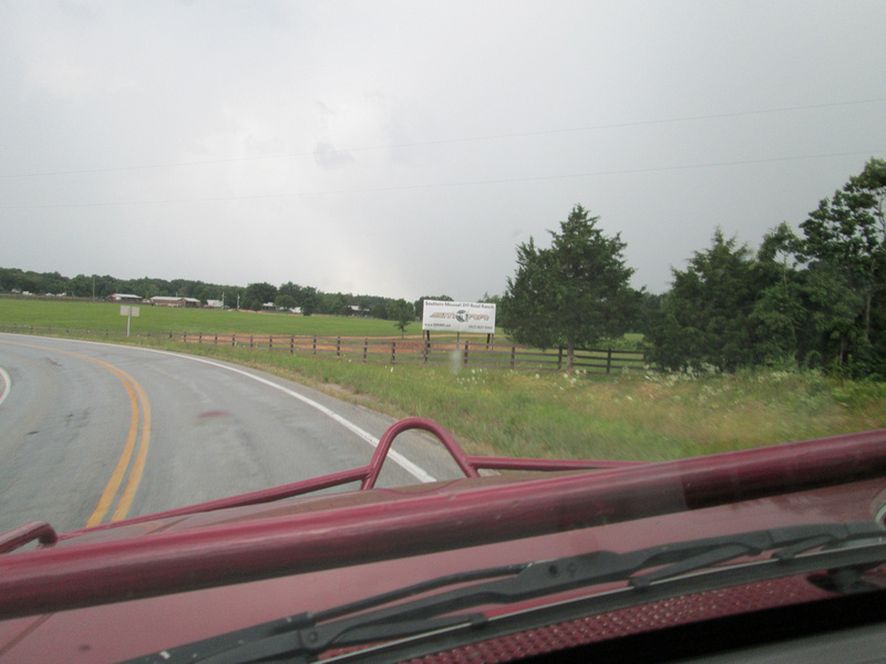

Just outside of Mt. Grove MO, we ran into green skies, cloud rotation, and some major rain and cross winds. The wind blew me onto the should at one point, and it was blowing hard enough to force me down two gears. Crazy!:

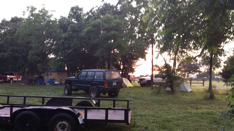

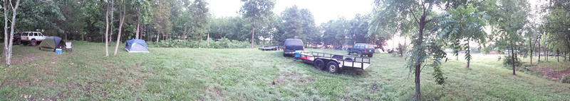

All was calm when we reached SMORR though which was nice as we were tent camping for the night:

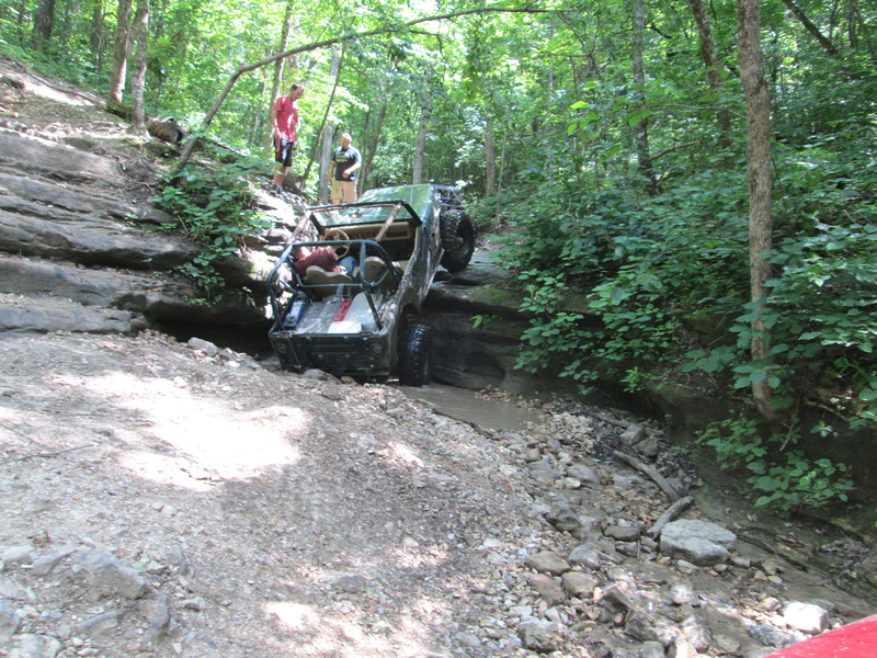

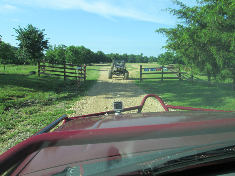

The next morning we started following Al around in his Truggy hitting some of the sights in the park. While I didn’t get to run around all day due to my running issues, I still managed to cover 11.25 miles which isn’t too shabby:

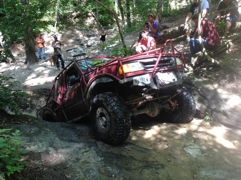

This was a fun little waterfall. Lots of traction!

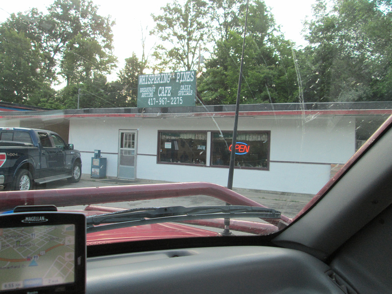

Saturday Night It rained pretty good which put a damper on the night wheeling, so Sunday Morning I packed up a wet camp and hit up a small café in Houston for Breakfast:

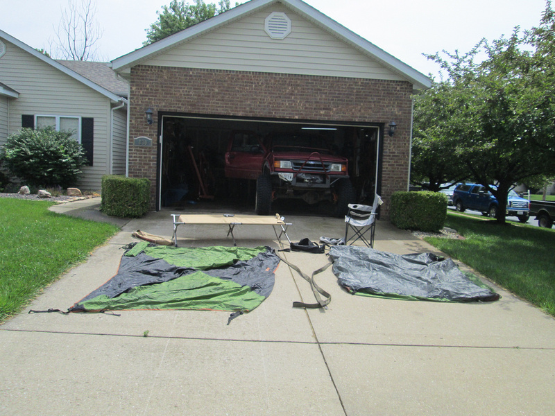

And threw everything out in the sun to dry out when I got home:

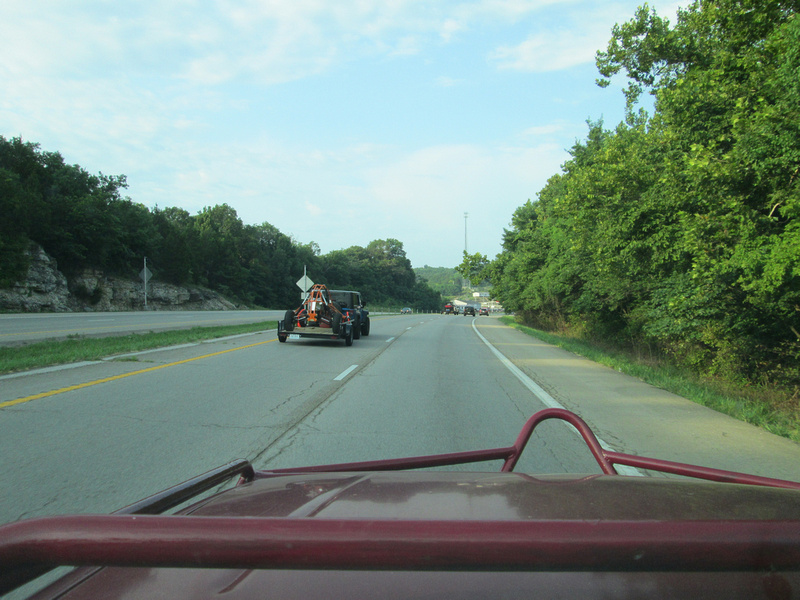

St. Joe State Park is nearby and we kept seeing some high dollar sand rigs pass us by on the way down:

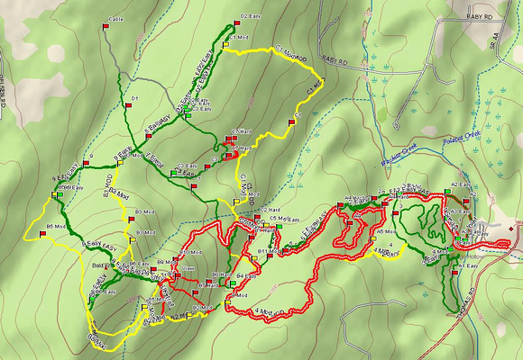

We traveled about 6 miles wandering through Fubar (A4), up and down Outside the wire (B10), part of Parris Island (Spotters alley), and taking the casual route out on Ground Pounder (Trail 4) to Swamp Doggie (A5):

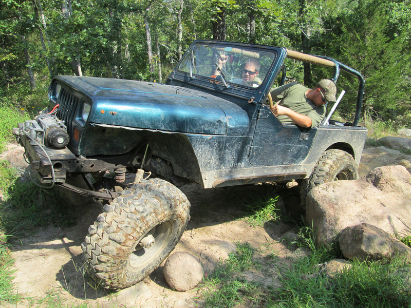

Slide show link to the rest of the photos: Link
No real damage from the group other than some overheating. I did mange to bash in my drivers door a touch more (the window actually goes up better now!), and bend my rear DS again. I wound up having to make the trip home in FWD which really sucked with that locker in there. I’m in no hurry to do that again! Light duty Tcase 4tw!
