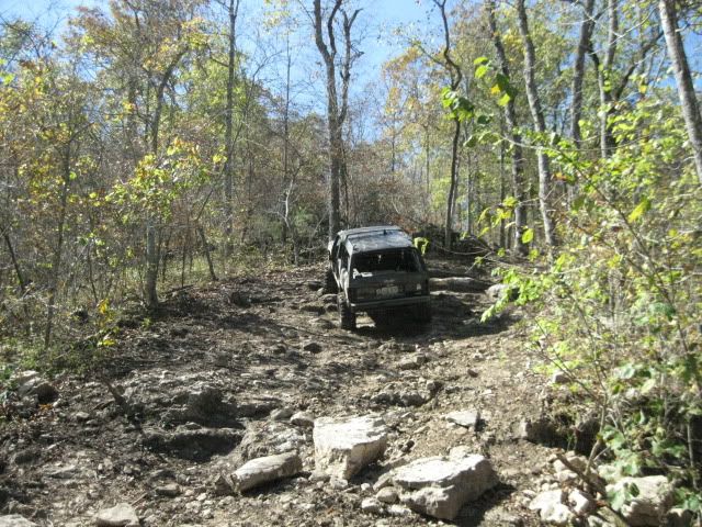

Well we made it down to SMORR again for their “SMORR in the fall” event. Which mostly just entailed us wandering around SMORR again. The truck did fairly well, but it was not without some downfalls.

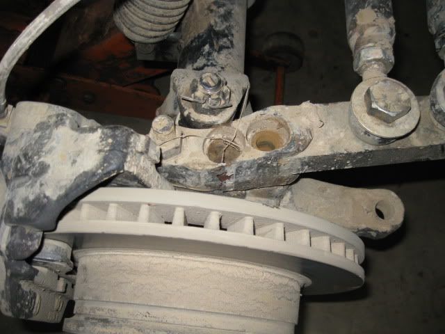

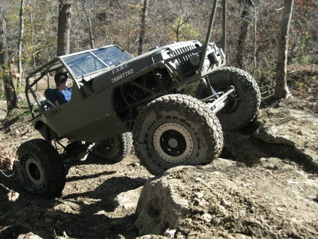

Unfortunately, not too long after taking those photos, my junk broke yet again. We were literally heading out of the park on an easy trail when I managed to shear 2 of the 3 5/8 bolts that were holding on my high steer arm on the passenger side knuckle
The fellow with the black buggy was nice enough to run back to camp and grab his tow rig to drag my junk back to the campground. I’m very thankful for that as I was somewhat dead in the water with next to no steering.

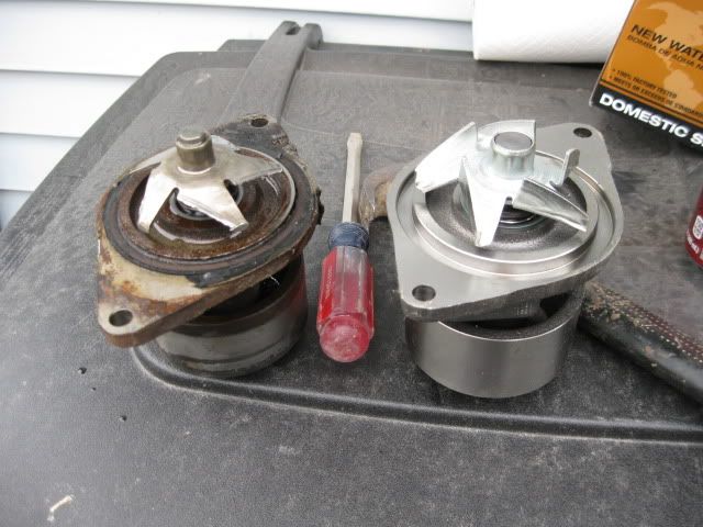

But I’m noticing nothing is ever easy in my world, as about 20 miles away from home, the tow rig threw off the serpentine belt off. Of course this meant we were rolling down the highway loaded at about 19k lbs with no power steering (no biggie), No breaks due to no hydro boost (that sucks), and no trailer breaks as the alt wasn’t putting out enough juice to fire the trailer brakes (That really sucked), and an overheating truck. So we wound up limping the truck off the interstate into the downtown Cahokia area. Which if you know the area, its not really a place you want to break down at night.

I took a half day off of work to fix what died on the Dodge. Turns out the stock water pump on these guys likes to die at about 170k miles on the odometer. And when I say die, I mean really die:

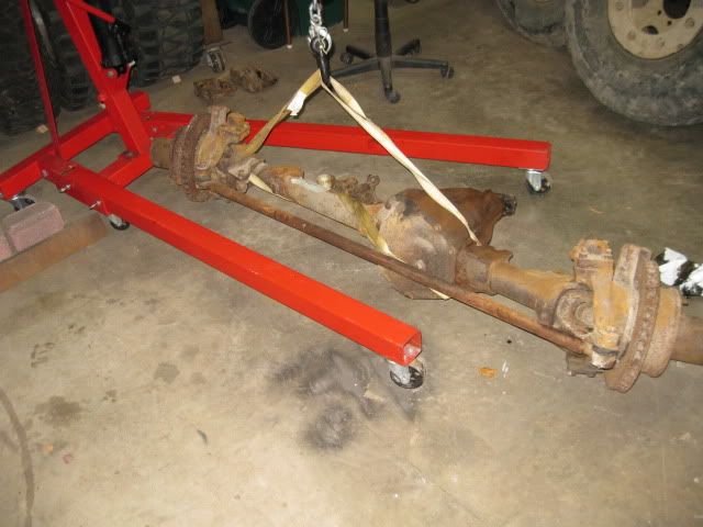

I’m pretty sure the high steer failure was due to the bolts loosening up and just letting go (had hit a rock when they broke). So it was just crap luck on my part. I had always said I’d rock the 44 until it gave me too much trouble and at this point I think its given me too much trouble so this is going in its place:
A ’78 king pin 60, I hope to get it torn down this weekend to find out what it’ll need.

I was planning on going ball joint (and possibly even unit bearing) but this one showed up at the right time so I nabbed it. It needs some work, but at least with the 60, any money I put into it I should be able to get it back out of it if need be.
