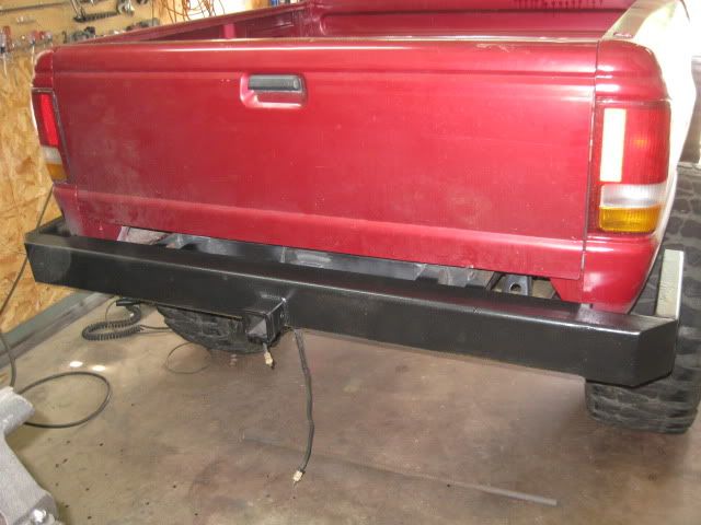

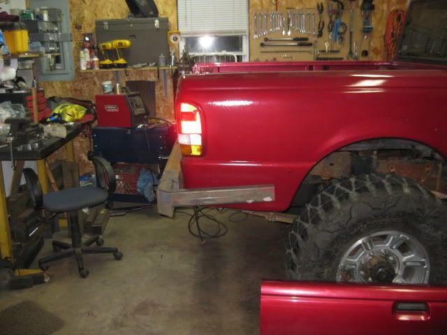

The rear bumper is done for now. I'll get an update here shortly. I also started on the belly skid and finishing up my exhaust (which is a little louder than a stock Ranger, but not too bad)

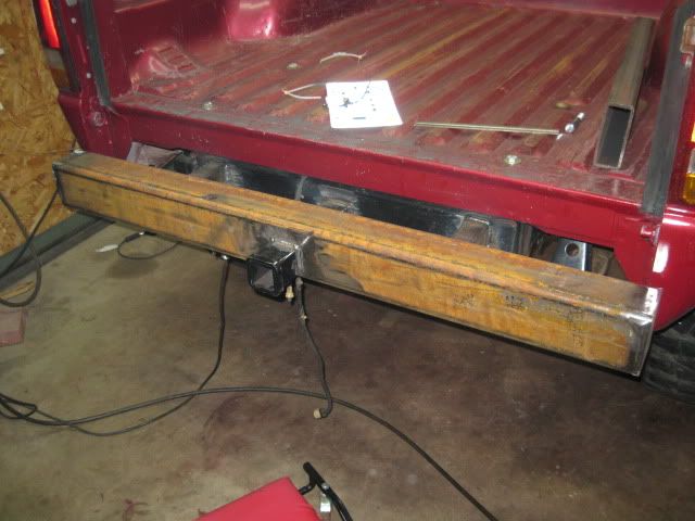

Rear Bumper Air Tank

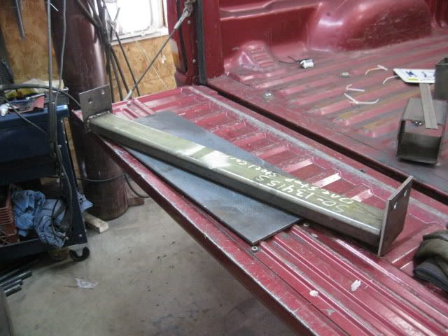

The rear bumper isn’t anything special, Just some ¼” wall 4x5 that Is capped off to be an air tank in the future (If I remember my measurements right, its about a 4 gallon tank size) .

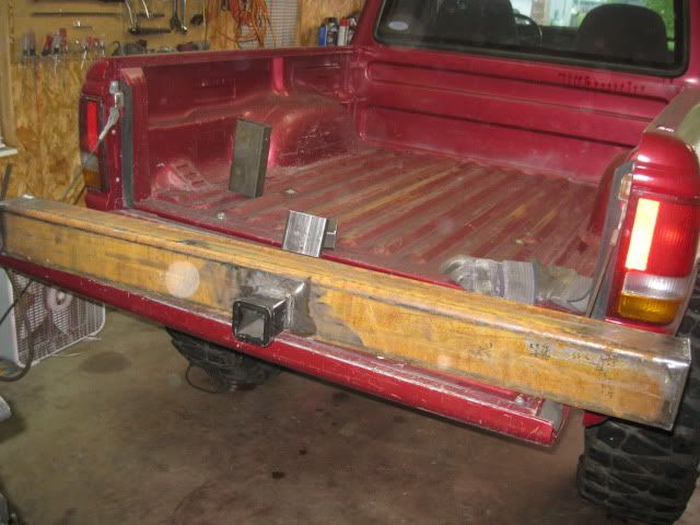

I took the center section to work and milled a hole for the receiver mount. After that was completed, I burned on the end caps and receiver:
And burned on the truck:

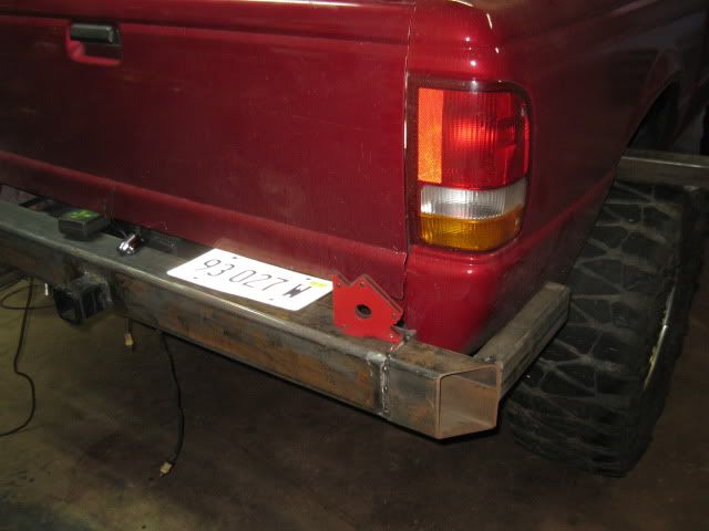

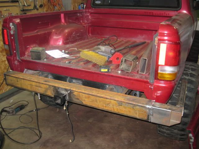

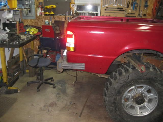

At this point I started playing with the side tubes some. The first try was a bit too long for my taste:
So I shortened everything up a bit more:
That’ll work, so everything got burned on and had some spray on bed liner applied:
(The side tube is level and square, I don’t know what up with this photo, body lines maybe?)
Now I just need to plumb the air (and get an air source), and add the license plate. For what its worth, it does measure the correct height for IL 625.

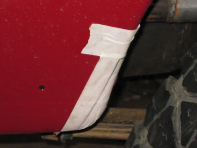

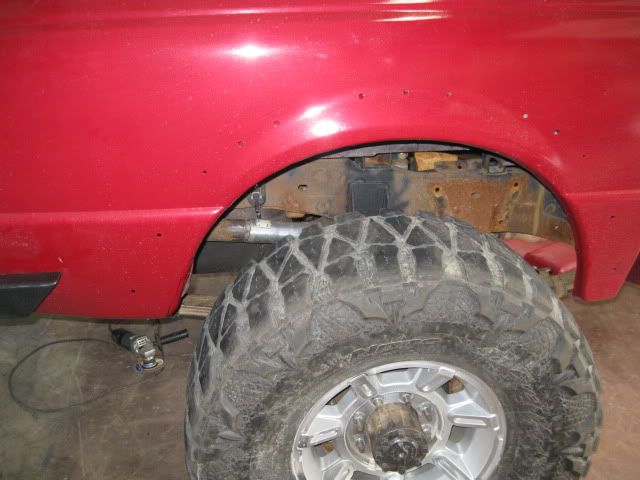

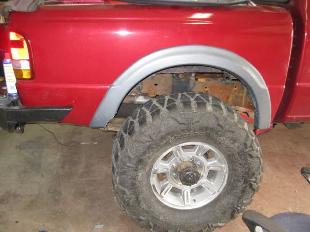

Fender Trimming
Very little trimming was required in the rear:
And with the flare back on:
I might have to trim just a smidge more back here, we’ll see when I flex it again.

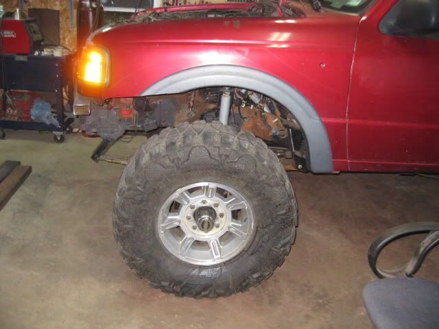

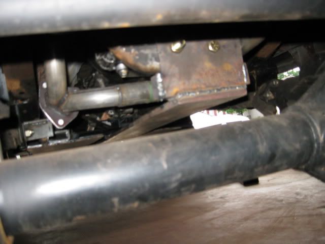

The front needed a bit more aggressive of a trim job:
I wound up leaving some of that little bracket in the front to make it easier to mount the inner fender liner too. Hopefully it won’t rub the tire too bad at full stuff.

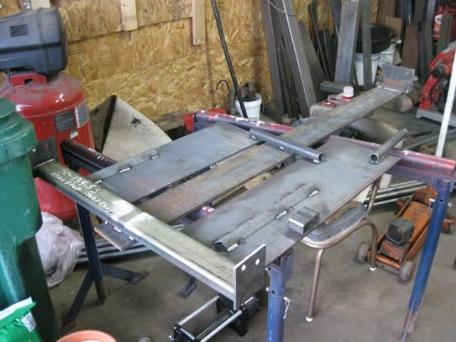

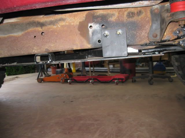

Belly Skid
In my XJ, I had actually spend some time making a ‘contoured’ transfer case/tranny skid. That resulted in decent ground clearance, but also meant that I always wound up high centered on one of the nooks of the skid.
So this time, I gave up some clearance in order to have a flat belly. The net result is that I only lost about ¾” and I now have a stupidly stout (and heavy) skid. This thing pretty much threw weight savings out of the window.
So I started with another cross member:
And then started grabbing flat stock (the center is ½”x5, The outer two plates are ¼”):
Added some bracing:
Burned it together, and stuck it back on, didn’t lost much in clearance:
The center bar ties into the front K member where the TTB mounted before (I’ve never hit my engine skid before on the XJ, so I’m thinking this is overkill):
It’s a little hard to tell but there are two cross members, the rear most one, and the transmission cross member. These carry the brunt of the load. I’ve also got a tie in to the front “K” member, as well as the spring bolt on the passenger side rear leaf mount.

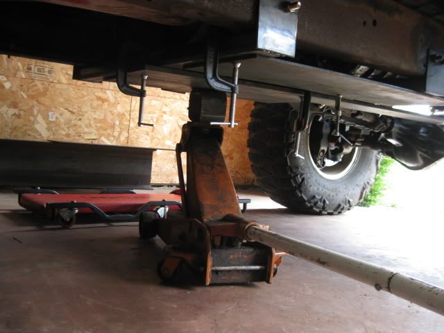

So we’ll see how this one works out. I put the trucks weight on the weakest part of the thing and managed to pick the truck up without damage to the skid or truck. So while this is stupid heavy, it should work just fine.
