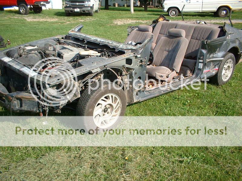

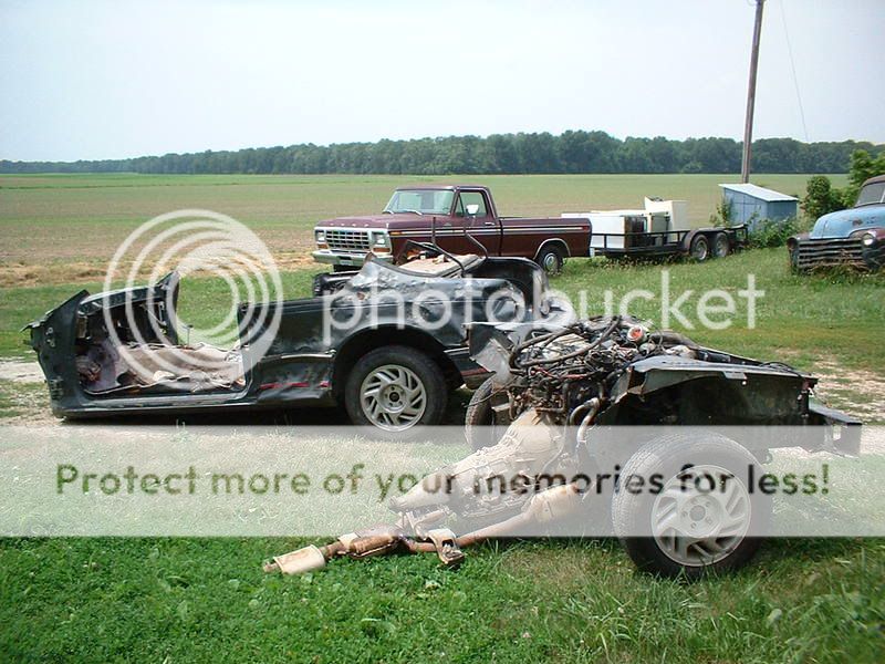

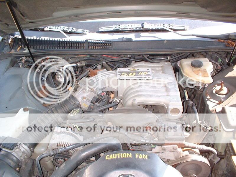

And some pics of my '92 Thunderbird donor car WITH a 5.0 HO

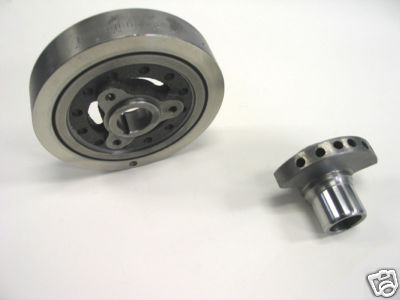

there is a vehicle ford made, that had half a harmonic ballancer... it kinda looked like a cam shaft lobe, kinda... it was weird... i forget what it was on, i thought it was a version of the 5L but i could be wrong... i know my 89 5.0HO has a full size balancer...
I think this might be what you are describing, came only on the 428 SCJ to make up for the extra weight of the stronger, heaver rods. That's the motor that came with my '69' Cobra but motor, trans long gone.
Dave
the thing on the right is kinda like what i am talking about, but not quite... it's something like that, then the pulley bolts to the front of that, though it's a slightly different shape...
That thing on the right is actually shown 180 degs out of location and fit behind the dampener, slid into the front cover, pulley bolted to the dampener. There were less than 560 of the Fairlanes Fastbacks that came with this motor so they are rare and parts expensive. Can't think of any other motor running something like this.
