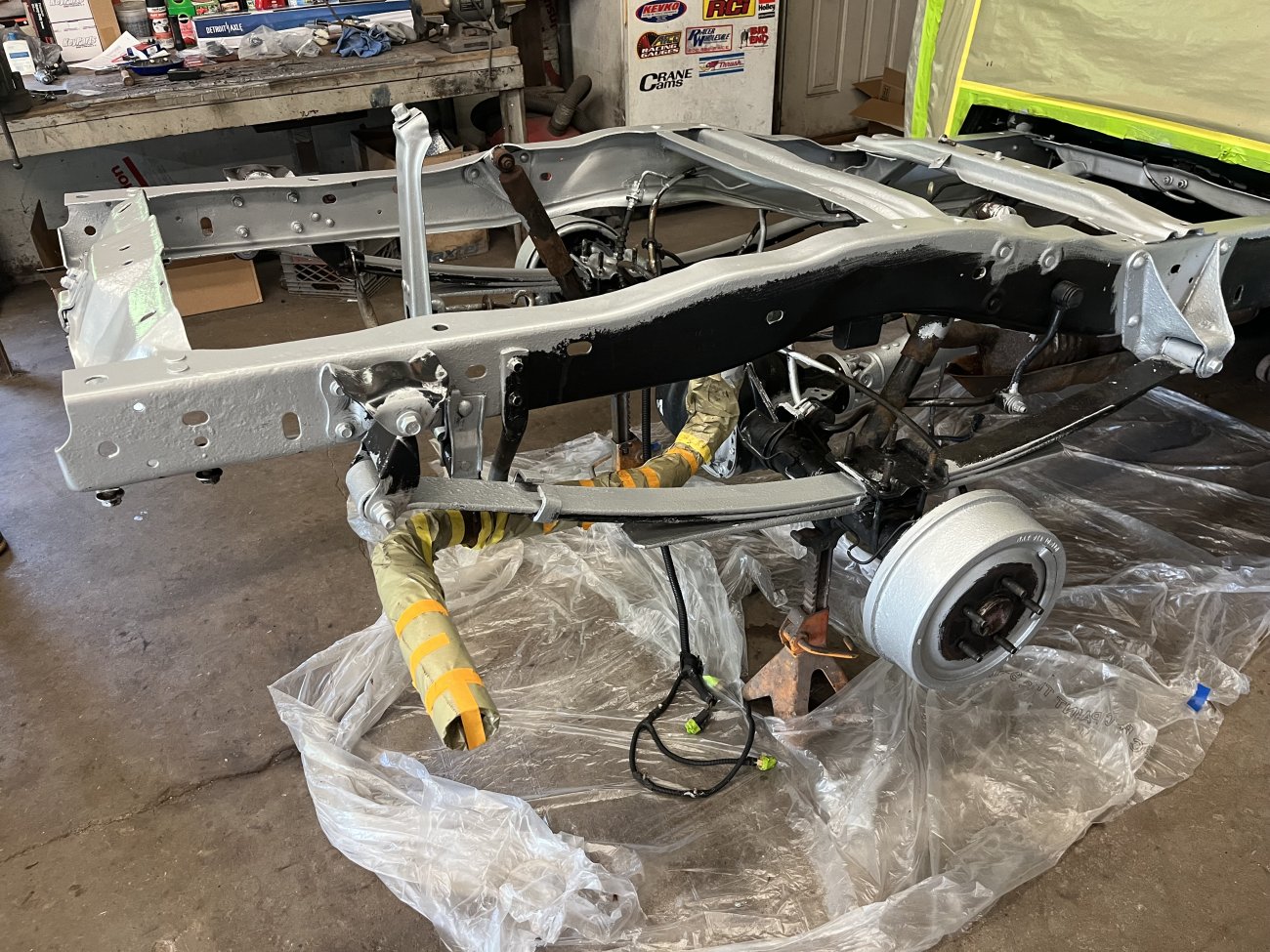

The encapsulator (silver looking crap) application took me about an hour to put down and I spent a considerable amount of that hour sipping cold snacks. The de-scaling and lacquer thinner cleanup was probably around 15-20 hours of labor... keeping in mind, I work slow and detailed, getting into every crack and crevice (where rust usually grows and gets out of control). And the Eastwood stuff wasn't bad, I just used a mini-paint roller for the easy stuff, then a 2" paintbrush for the hard to get to areas. I thought about spraying it (you can spray it with a 10% reduction or something like that), but it's a high solid content/ high build and I don't have a shi**y gun for spraying garbage and I'm not in the mood to use my good gun for that stuff. I figure no one but me will every see it anyway and the finished surface wasn't all that bad really.

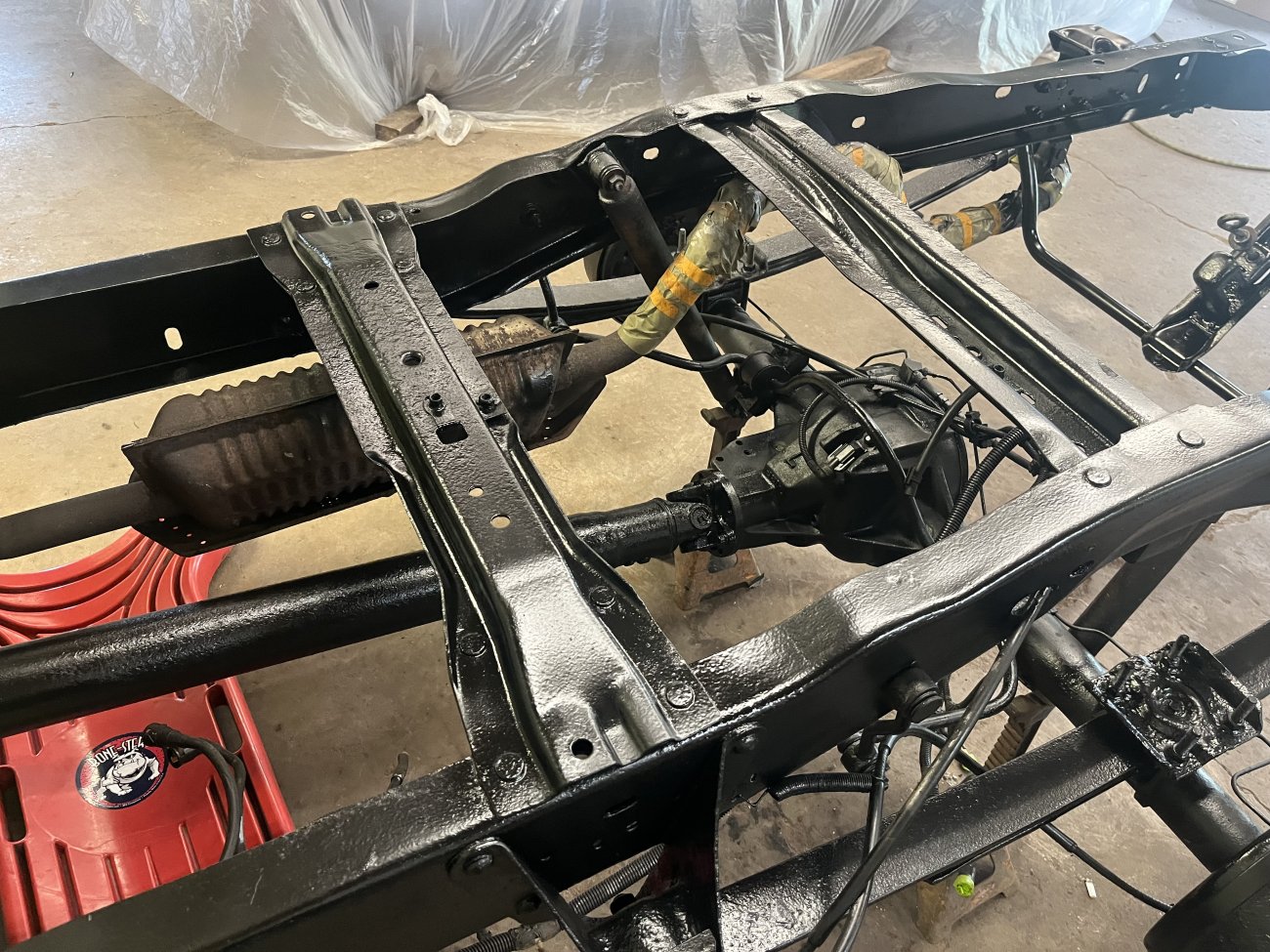

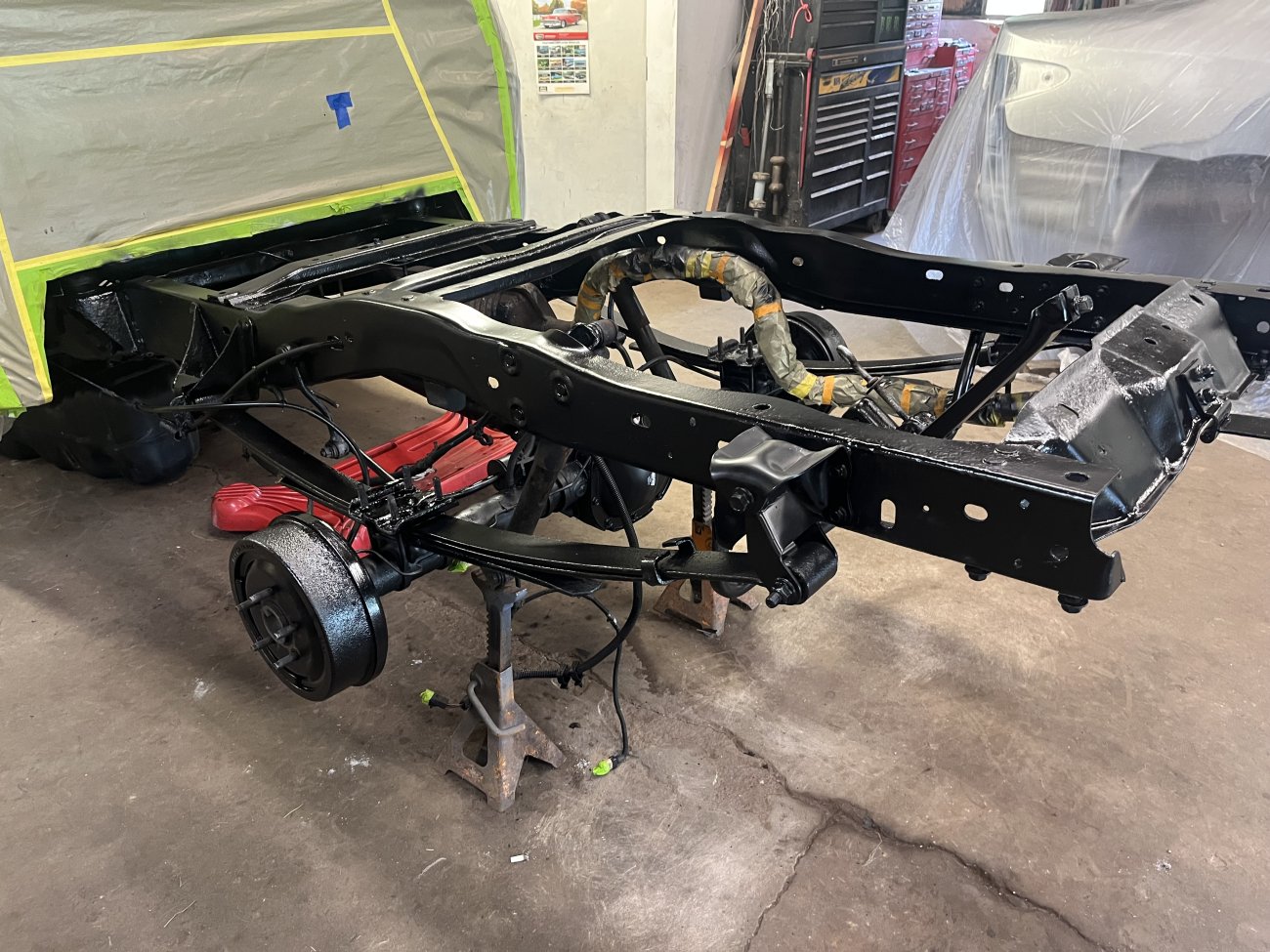

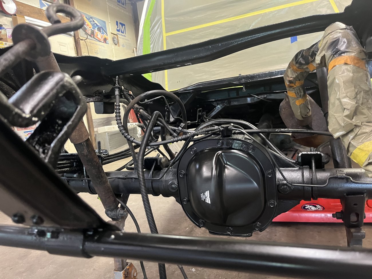

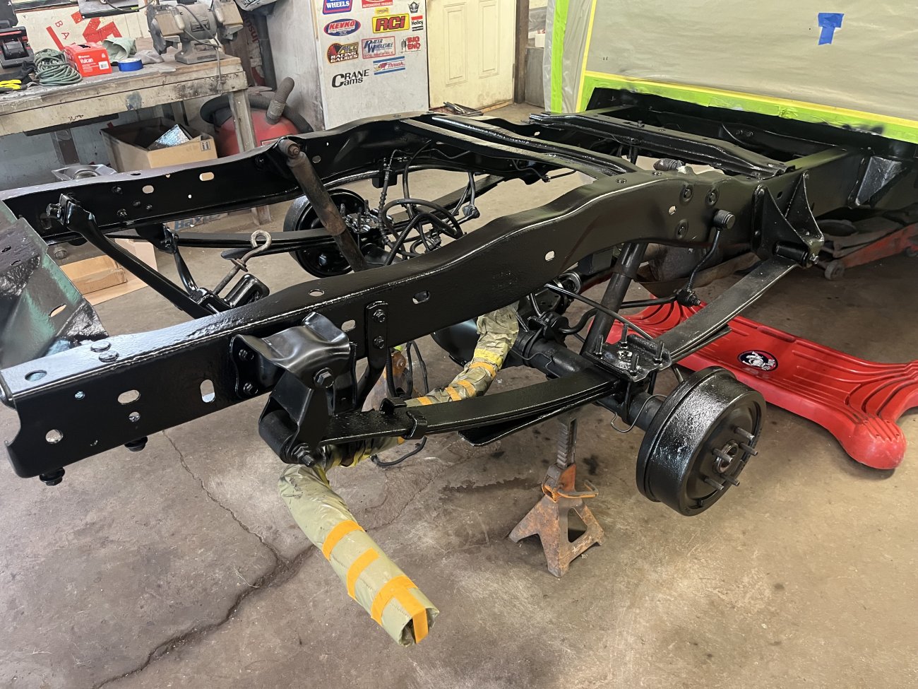

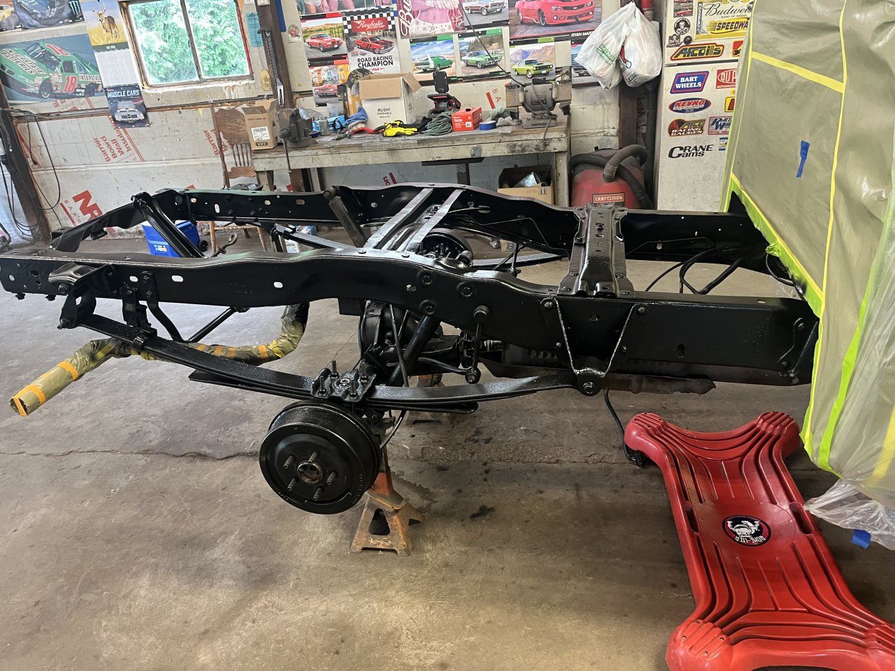

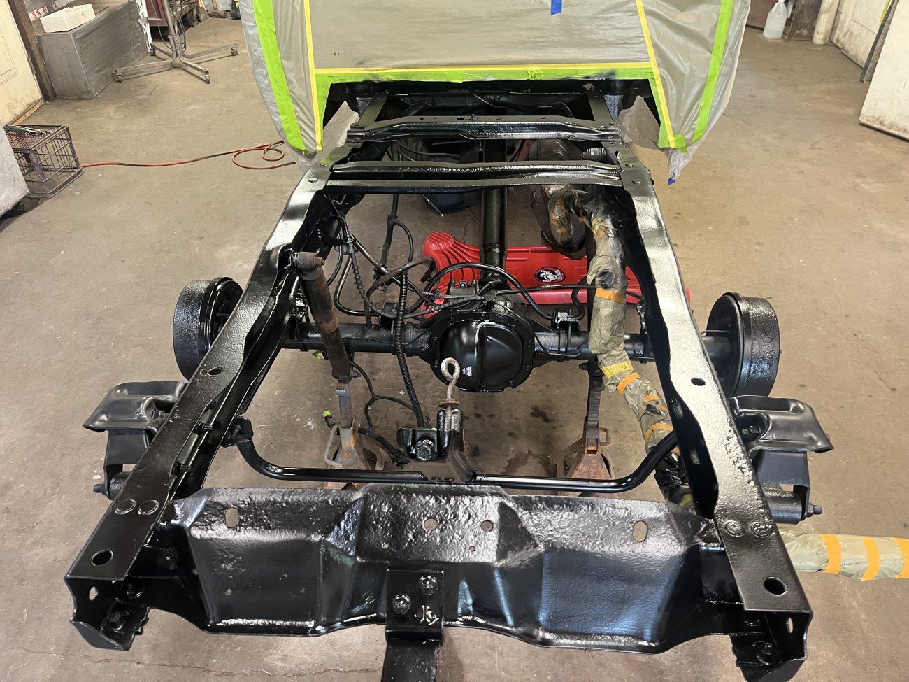

Update of the rear frame restoration and body work. Just to re-cap...
- body panel rust repairs covered above. New cab corners, FL fender lower panel and bracket, radiator support repairs cut out rust and patched up, bed lowers behind wheel well replaced.
- de-scaled the frame with an air needle scaler, then light cleanup with wire wheel followed by lacquer thinner wipe-down to degrease everything til nice and dry. This was a LOT of hours of hard work getting it right. Replaced rear spring mounts as they were rusted pretty good with a couple of holes in the tops. Still structurally sound, but they weren't long for this world.
- First coat was Eastwood rust converter applied with a mini-paint roller and a brush in the tighter spots, cured for 6 days
- Scuffed surface with red scotch-brite followed by another soap and water wash and dry, then applied the Eastwood Rust encapsulator "platinum", applied with a mini paint roller and brush in the tight spots. Allowed to cure for 6 days
- Another light scuff with red- scotch-brite (encapsulator is hard as nails so it didn't do much to it), alcohol wipe-down then rattle can spray with black chassis paint. I used the hi-temp VHT "Roll Bar and Chassis" black satin finish.
Overall I can't claim that it looks "good", but it looks a lot better than when I started, and I know it is a solid application, won't flake or peel, and the frame is now preserved. I am wondering if I should have just replaced the front spring mount brackets while I was in there, but they were rock solid, just surface pitting so I couldn't really justify the hours doing it.
I'm going to guess total hours were somewhere around 60 hours and around $600 in materials including the body panels and all the Eastwood crap which I bought WAY too much of and gave the remaining 3/4 away to my buddy who is gonna use for something. In reality, I needed 4 rattle cans, 2 quarts of rust encapsulator, and a quart of rust converter. All the color was about a pint with some left.

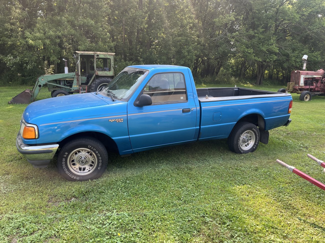

EHEM: My 1994 Ranger is now truly RUST FREE and I can say it without qualifiers.

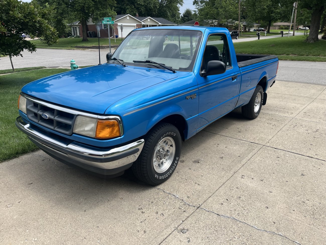

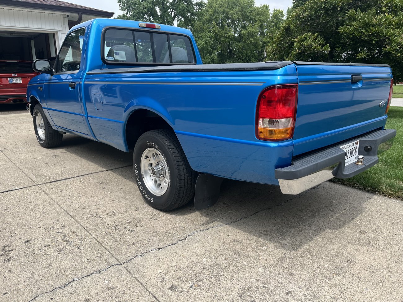

Well, got it all cleaned up. The only thing left is to swap out the tires and wheels with the 15's I refinished last fall and a new set of tires. I ordered General Grabber AT AND I'm really hoping it wasn't a mistake. I obviously have a mini RWD truck, but I really needed better tires for snow. I'm just concerned they will look too aggressive on this type of truck. BUT... too late now. I'll have them mounted on Saturday and see how it looks. I'll be so glad to be rid of these 2 decade old Firestone's that I've been driving on for 2 years now.
I also have a set of "CoverKing" custom seat covers on the way... trying to keep the interior in good shape. I'll post pics when I get them and install.
I hate you :icon_hornsup:
Damn that looks soooo good.

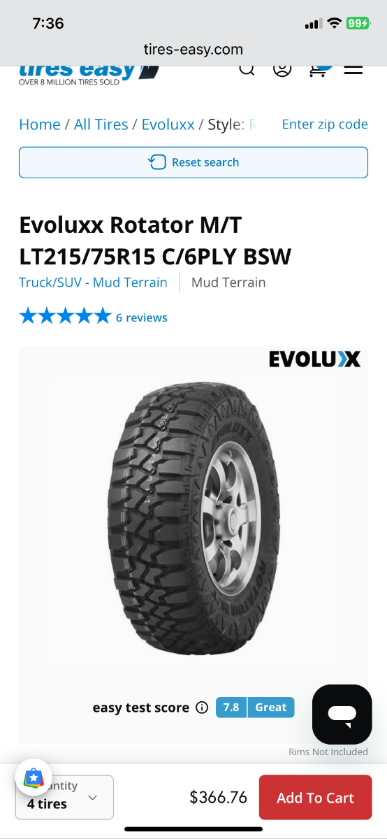

That cleaned up nicely. If I switch to 15s, will be running LT215/75r15 mudders…
