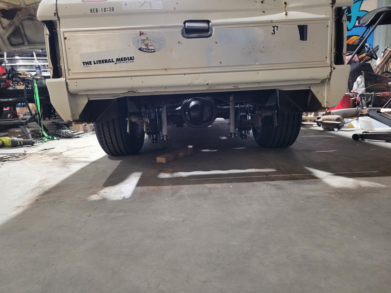

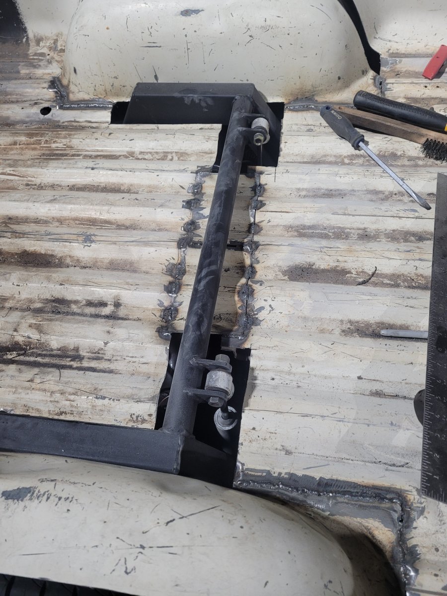

It looks good on the brake line move. Any plans to brace it in anyway? Vibration does weird things and could cause a chaffing/rubbing issue. You know more than me when it comes to custom automotive work, but the airplane mechanic in me is cringing a bit on that long of a tube not having any support.
i suspect its good. but a piece of strap say 14 ga welded to the housing to bend tab it in place, up top in the center of the housing with a piece of hose around it might not hurt. or maybe it will rub a hole in it.
the nichrome lines are weird when it comes to support i noticed.
but i been doing the ziptie through the hole thing mostly the last 12 years or so with it up in the rust belt... so maybe i am an idiot.
When I installed the ARB cover on the trucks, I had to go the zip tie route since the cover uses different bolts and the recesses for them would not allow the bolt/stud things to be used. They are under the truck, away from UV. So, they have held up pretty well. Sometimes, you gotta do what you gotta do.
Cut some more holes.

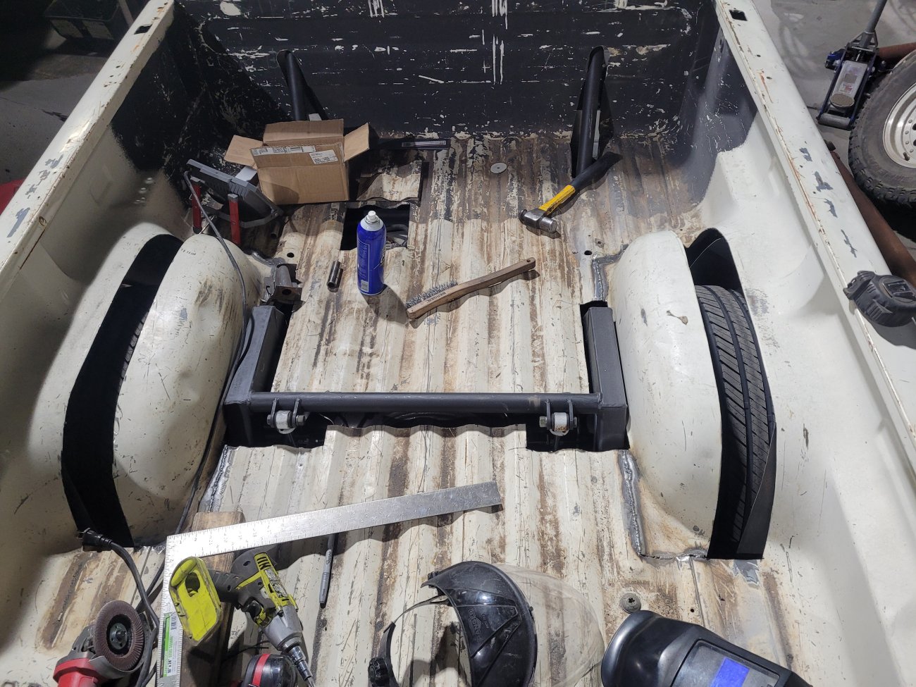

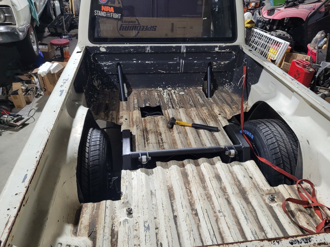

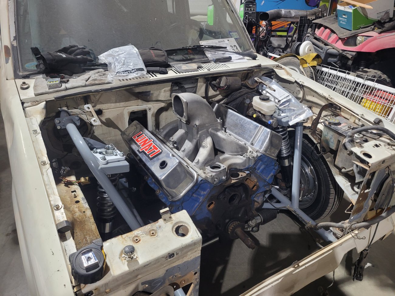

Added a couple of pieces under the shock mount to tie the bed floor back together. I'm going to add a couple of bed bolts to the front half and call the back end done for now.
The $600 1988 Ranger project... a twin turbo big block build.

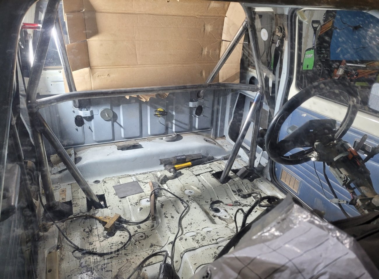

Hard to take a pic. Had to take this one thru the windshield.
I was happy that I had extra tubing on hand because like the genius that I am, I bent the end of the harness bar the wrong direction. Haha. I'm stupid.
Next step is to fit a seat. I'd like to do that before putting the door bars in. Just so I don't have to crawl over the bars to make the seat mounts.
