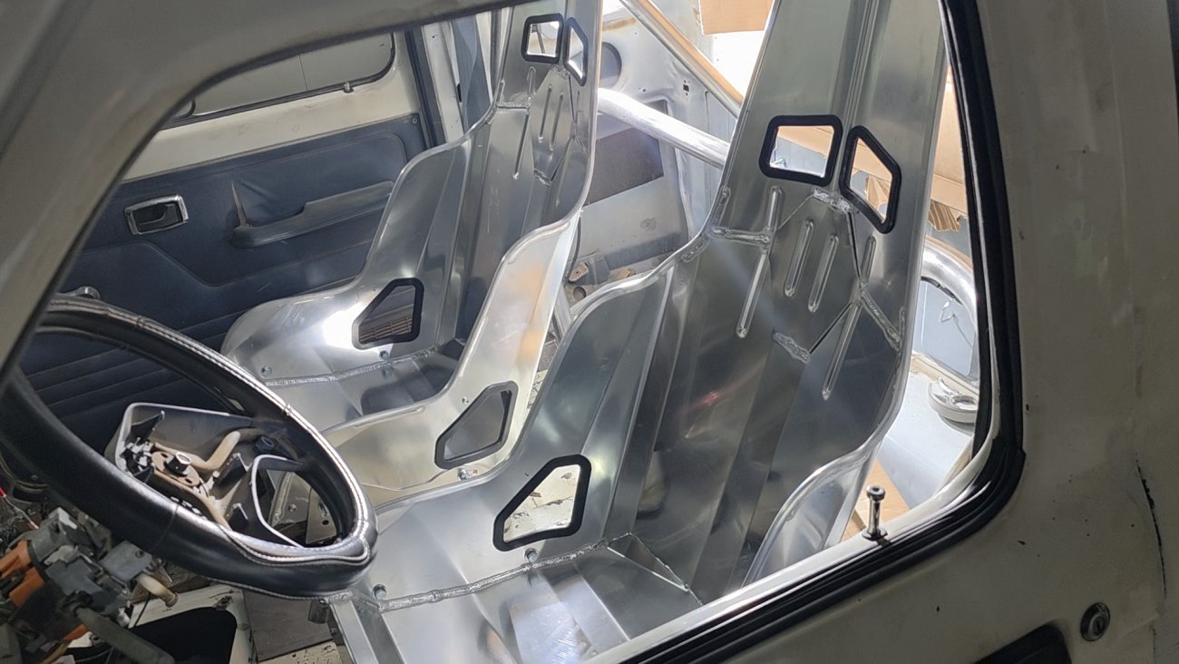

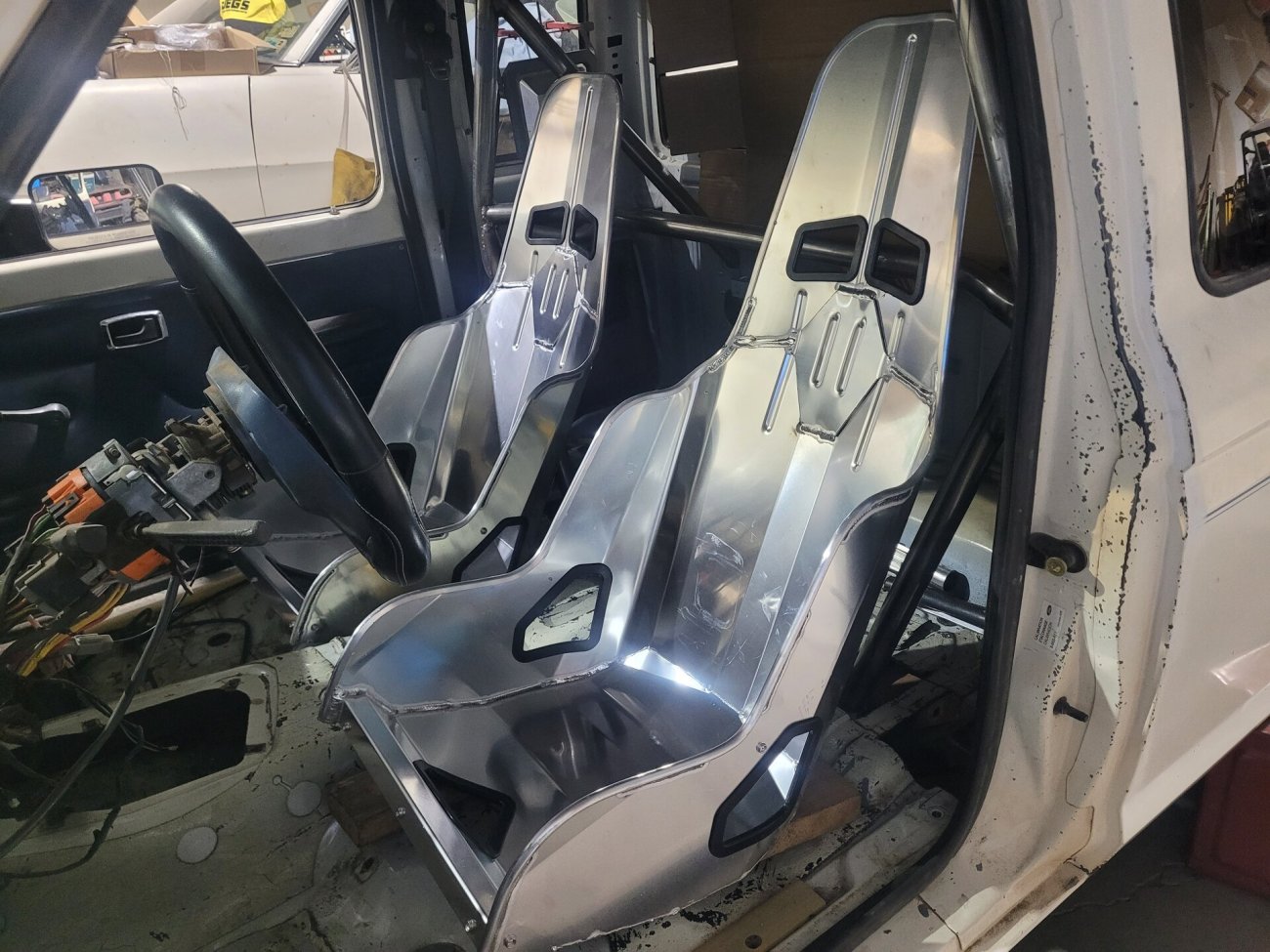

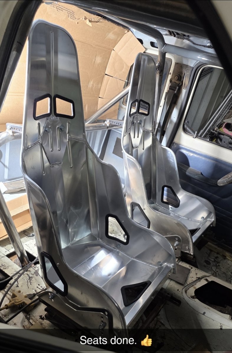

Very similar design to my old Kirky seats.

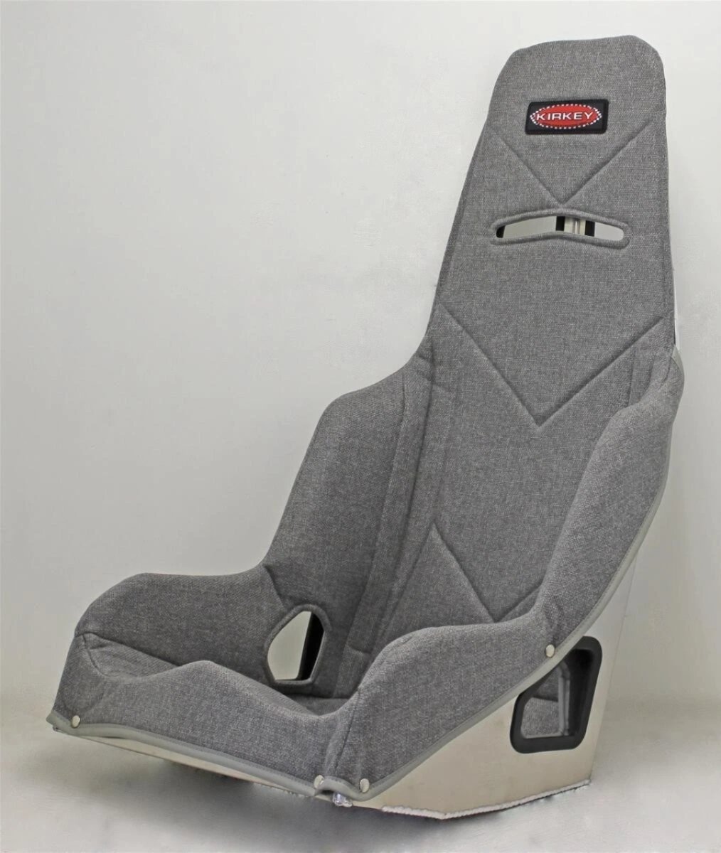

They will have padded covers like this so maybe they won't be too bad. Haha.Looks great but I don't know how long I could ride in one of those. LOL.
I used closed cell foam padding on mine. It comes in 2' x 2'x 1/2" pieces. I used 3 on the bottom and one up the side and back. Then the same cover as pictured above. Not great but survivable for the short course races I was doing.
Are your shoulders below or even with the bottoms the holes in the back of the seat? I ask because spinal compression is no joke in an accident. The shoulder strap anchors should be even with the tops of your shoulders. They are meant to prevent forward movement. The lap belt prevents vertical.
