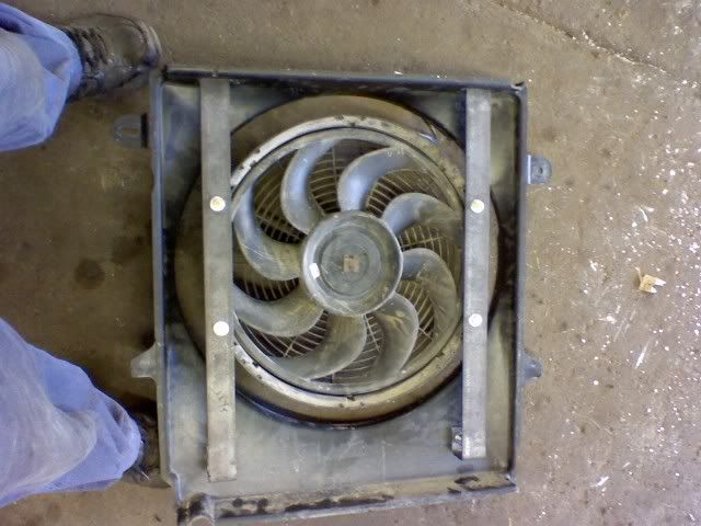

and heres my story, everything was good until i converted my truck to 4wd, then the radiator seemed to want to get packed with dirt and mud when off-roading, so i decided to put the stock fan and shroud back on to keep the mud out, well my MPG went to shit. i was averaging 300 per tank, then it dropped to just over 200 miles per tank. serious noticeable difference!
so i decided to reinstall the E fan but i made some brackets and mounted it to the stock shroud. so i get my MPT (miles per tank) back and no more mud caking at the bottom of the radiator.
the "anti electric fan gods" can preach all they want, there is a difference!
