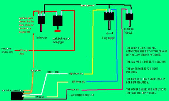

These are 20 year old captain cave pig pictures and paint by color diagram.......I may have a version of this panel around the house I can maybe take pics of......I thought I had a write on it here. It was just a crude setup for prototyping. This side was a version of brake control. I was hoping to find a pic of the gauge side...
You can just see a gauge....there are a few. All electric connected to oem style psi and temp sensors via a rotary switch.
Two gauges can watch 10 items as selected.
The brakes I had setup for cutting and waterbox....just like the new bronco has as a factory option now. I had a hand held remote as well.
