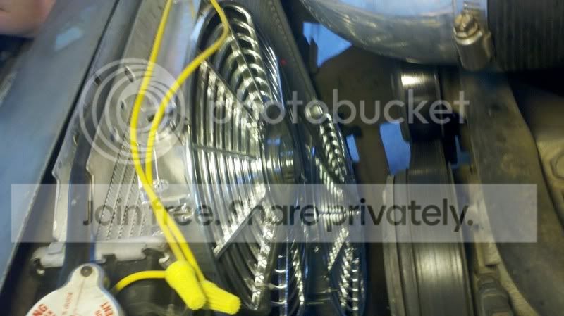

well lets see if this works. let me know what you guys think.

^^ i think you need to get rid of those marrettes, they are for wiring that doesn't move (like in a wall) not for applications that will bounce around... those will fall off and you'll find yourself shorting out like crazy
10ga speaker wire is more than thick enough to handle the draw of the fan... 12? ga speaker wire is virtually identical to "lamp cord" which you would get at the hardware store, and is the wire that you run from the wall socket, to the bulb on a floor or desk lamp, the difference being that speaker wire is fancy looking, and clear, and about 3 times the price
that being said, there IS a downside to speakerwire under the hood, it's UV and oil resistant, so the rubber will break down quite quickly, which is why they sell automotive grade wiring
other than that, looks decent... the problem with having the fans mounted directly to the rad like that, is they won't suck as much air as they could... that's why people use shrouds, it creates a vacuum behind the entire rad, and pulls air through the entire thing, not just the surface area that the fans cover... it's a way to effectively make the fans cover more surface area, and thus more surface area for coolant to cool down...
that being said, i doubt you will have too many issues, just watch your gauge closely through the summer months, to make sure you don't overheat... and if you've got one of those wonky stock ones, i would put an aftermarket in, just to be safe...
