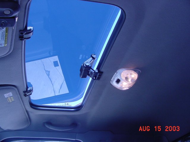

Not to bump an old thread, but I'm going to be installing most likely a C.R Laurence Newport 14x32" pop up sunroof. Seems to get good reviews on everything i've read for the autoport/newport line.
http://www.amazon.com/gp/product/B000GVQEIU/?tag=959media-20
Seems pretty simple as far as install goes and parts seem to be readily available.
Might pick up an extra seal just in case but overall it seems to be a decent cheap mod to do. I just want more light. Being a single cab I don't want an electric sun roof. I have an overhead console and found pictures of someone that has both. looks really good to me.
