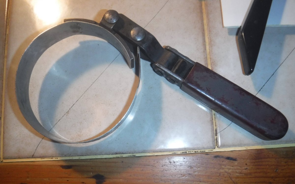

CMOS
My filter socket of choice :)
  • Suggest an Oil Filter socket...
