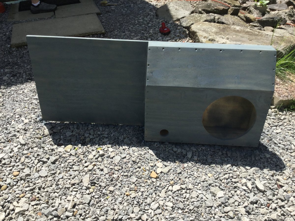

I’ve built two sub boxes so far for a Ranger. One was for a single 12” and the other was for two 12” subs. Made them to fit on the ledge in the back of an extended cab and they come up to right under the window. Forget what it worked out to, but I believe it was roughly around 1.2 cubic feet per sub. I built them out of 3/4” plywood, I bought some B/C sanded 7-ply. Thought to do it with cheaper 5-ply but there was too much void space and it just wasn’t solid enough to try. With the trim removed from the back of the cab it doesn’t stick out past the ledge in the extended cab.

@MaicoDoug here is the two sub boxes I made to sit on the ledge…

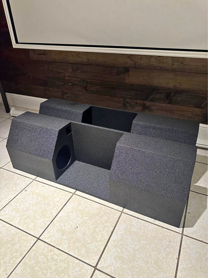

Check out this website.............. SUB BOX PRO
Sub box for a ranger?
An idea for a pair of 8 inch'ers I saw recently. 13 inches to the rear of the console is all there is. This may be excessive but need to do the math & see if I can get 2 cubic ft. Been busy with the local festivities. Man, I really want to toss a few $$ for some nice drivers, but.....then there is that real nice 12 SPL unit I have.

I had a bigger sub box in my first Ranger and I didn’t like losing the extended cab space, that’s why I started building thinner boxes.
I'm looking at stuffing these in the rear lower corners and hoping for 1Cu Ft per. Maybe 3/4 Cu Ft if sealed. With a single piece of wood? Too easy, back to the drawing board....
