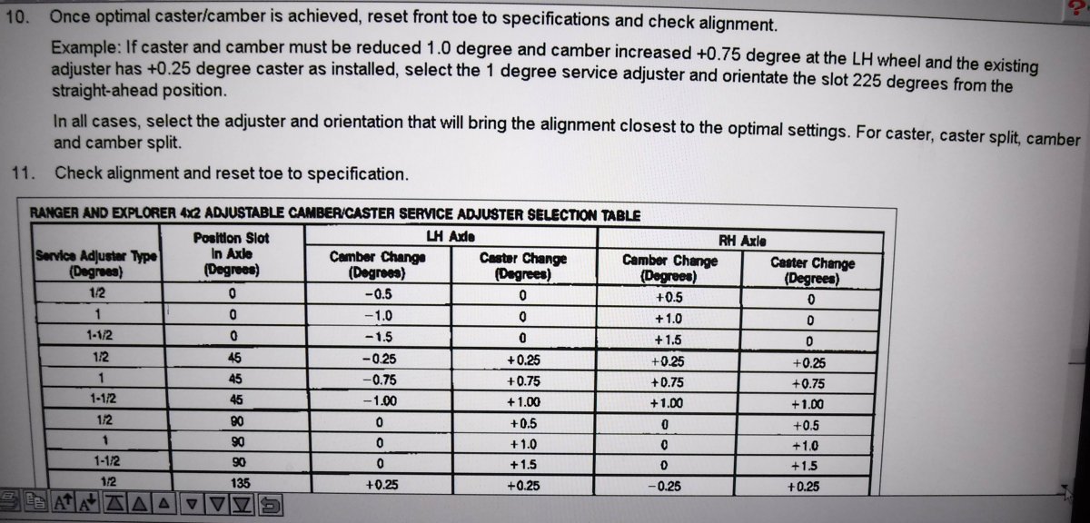

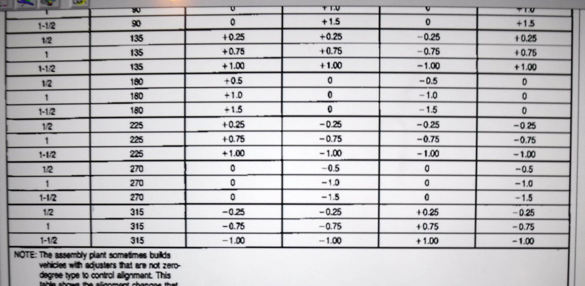

These are best I can do at the moment Rog, maybe you can sort it out. Hope it helps

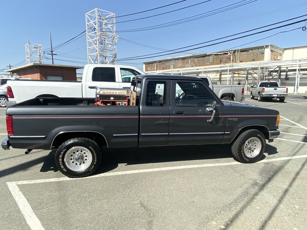

Thought I would post a picture of my dad’s truck he thought it was the best truck in the world!

Man, that's a nice truck you've got there
Those numbers on the 1st photo under the adjuster and the pinch bolt are the original Ford numbers, and in the last photo the numbers on the adjuster are likely true to the original Ford part. These came from a CD I bought on ebay shortly after buying my Ranger in 2006, it's Ford branded, and the same CD as they used in the Ford dealership repair shops (altho it's directed towards the 93-94 models)
Thanks, I have my Dads initials on the plate. He passed in 2013 I feel close to him when I drive it:-) Damn thing just pulls to the right:-( It’s not a huge deal it just bugs the shit out of me though. Hopefully I will find somebody to help me as time goes on have a good rest of your day. Roger
