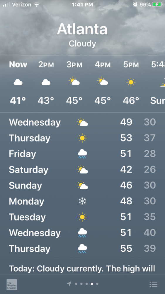

And I jinxed myself bragging about the south, it’s supposed to snow on Monday. The world comes to an end…
Weird. Sunny and 51 degrees. Is my Monday forecast. Similar, but cooler than today.
