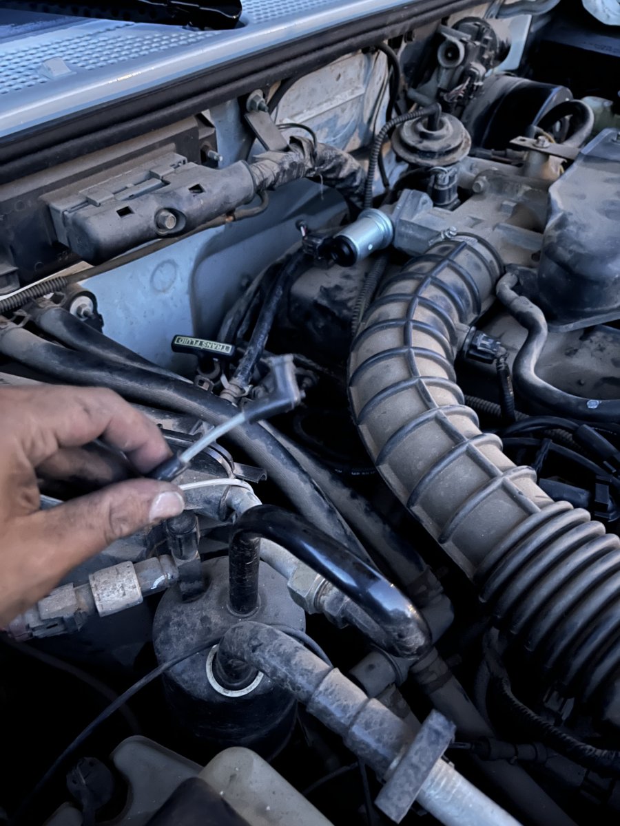

Also found this line not exactly sure what it goes to but I believe it’s a vacuum line as it had suction to it when I had the truck running.

Sounds like a vacuum line. And could absolutely cause P0171 code.

sorry to be the noob what parts are these in the passenger side firewall and line in the picture seems to be running from underneath that

AFAIK, the only reason to have a vacuum line there (based on that picture) would be if the HVAC controls use it. IDK if Rangers ever did that. The wife's S10 does. Earlier trucks have the intake there with a valve to flip from heated air (off the exhaust manifold) to the normal intake in the grille.

From your statement Senornoob it sounds like the line wouldn’t have anything with the slow crank/stall issues I’m having but thanks for clarifying it up for me
I'd plug it and figure out where it goes later...
That line is likely connected to your EGR solenoid/cap near the ignition coils, or to the HVAC system. Look for a round ball on the passenger side frame rail
