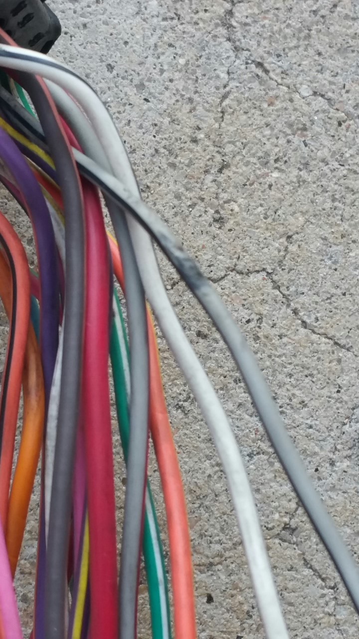

96 speedo repair.
Hope this helps someone.
96 4x2 3.0 auto. No power options. I added a cluster from a 96 explorer for the tach. Had to swap a couple of pins on the connectors so warning lights were correct. I pulled it a few times to paint gauge needles from white to orange. About a week ago it started fluctuating, a little at first then got worse. The Trans would slip and shift hard occasionally. I changed speed sensor on Trans and then the cluster. Nothing changed. I decided to trouble shoot the circuit and found my problem. Pic was taken through a magnifying glass.
Speedometer Problems [Check here first] --->
After I cleaned the wires you can clearly see the burn from arcing.
And this is where it was located. This harness is on top of the trans and the 2 forward connectors are behind the heads.
A couple of notes on checking for wiring issues.
Break circuits into smaller parts to isolate and rule out areas.
Disconnect things that might share a ground.
When checking continuity, you're not just looking for a good path on your wire. You're looking for a connection on a wire that shouldn't have one.
Before I got to this harness, I had my circuit divided in half and found ohms on a wire that should not have been touching mine.
In the end, I repaired the wire and the truck runs smoothly.
