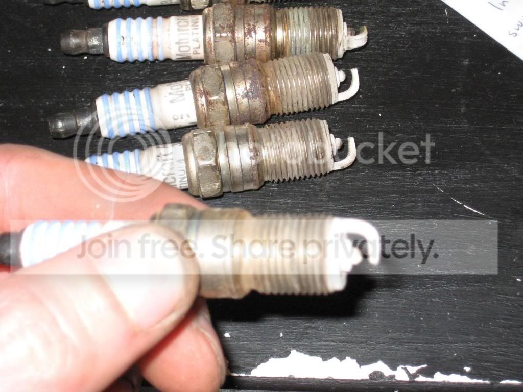

Here's a picture of the old platinum tipped plugs I pulled out. I was told platinum plugs should be good for 50,000 miles plus but these were only in for around 30,000 and as you can see they are pretty danged cooked with the central and side electrodes rounded and worn.

They don't look too bad on the business end, but they sure look like it's been a few years of duty...

Yeah, this little truck of mine has been through 46 states and most of them with that set of plugs. Things wear fast in the north. I'm glad to be back in California where the easy weather should provide the truck with many more happy years.
