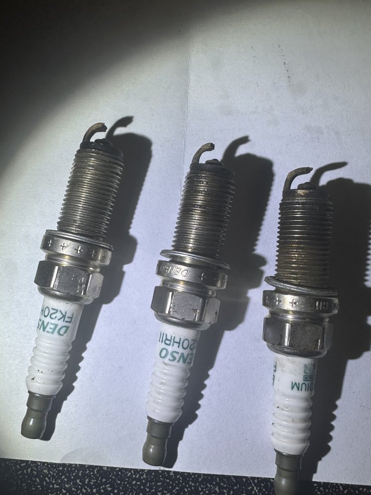

I was warned against trying to decoke and engine with this many miles so I didn’t do it. I pulled the 3 plugs from the front of the engine. They need to be replaced. The spark plug in the photo is number 6 but that is what they all look like.
moved the number 6 coil pack to number 4 and number 4 to number 6. The random #6 misfire moved to cylinder 2….. so I’m convinced it the plugs.

Definitely way too much gap and there isn't much left to the electrode in the picture provided.

Not much left of that spark plug.
I’ve seen it where someone runs old worn out plugs so long the coils get messed up. You change the plugs, and it helps, but only so much.
Have a friend with a 3V 5.4 that has original plugs at 150k. Runs like dog shit and gets 8mpg. going to attempt to change out his coils and plugs this weekend for him. I wouldn’t be surprised if hits cats are screwed up too from letting it go so long.

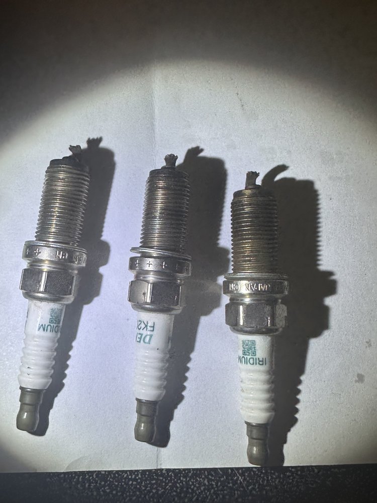

Spark plugs are changed. We had to use a cheater bar on the back 3. So new coils, new spark plugs. Cleared the codes, did the relearn. Runs like new again.
the rear 3 plugs were so bad I don’t think the dealership changed them at the 200,000 mile service. I think they only changed the front 3.
if you look close you can see how the ground electrode started to burn off.
