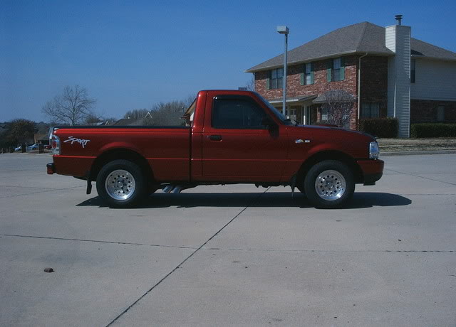

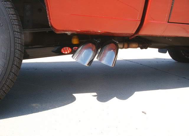

My exhaust isn't restrictive. No muffler, two outlets in front of the passenger tire. Just the converters there to somewhat mute the sound. LMAO! Note the nice and black Lakewood slappers behind the tips. No more wheel hop. Unbelievable, but those are made by Lakewood especially for Rangers. Been on there since like 2002, when I also put on the rear Hellwig anti-sway bar.
Sure, it's loud. A friends dad likened it to sounding like it has a V-8 under the hood. He asked me that one day while it was sitting outside his machine shop idling. He came in and asked my what size V-8 it had under the hood. I LMAOed, and told him 3.0 V-6. Him, "sounds amazing."

I'll keep mine just the way it is. It's just fine. I have no issue with paying for 93 octane. I run it in all my vehicles. As you can see from my last post, it's not a bad looking truck. I get people trying to buy it from me all the time. But, it's not for sale and won't be. If, for whatever reason, I had to start selling my vehicles. It would be the last to go. B-King first, M109R second, Lightning third, Mustang fourth, Ranger last.
Restricted is the wrong word to use on a 4-stroke engine exhaust system, no 4-stroke engine runs better or has lower emissions with any exhaust restrictions
2-stroke does need restriction
All Rangers have tuned exhaust, for mid-range RPM band, the tuning gives the engine more power in the mid-RPM band from Scavenged power
Scavenged power comes from exhaust Velocity flowing from a smaller tube into a larger tube, it causes a pressure drop which PULLS exhaust from the cylinder which leaves more power on the crank because it didn't have to PUSH it out
Exhaust ports on the heads can be made smaller to increase the velocity as well, which also carries the heat farther done the exhaust system to warm up the Cats faster, which does lead to lower "cold engine" emissions
But there is no restriction, ever
Many have put larger exhaust pipes on the head of many different engines, this is where the MYTH of Back Pressure comes from
You would LOSE POWER with larger pipes because you lose the Velocity and the scavenged power it creates
Car makes have used scavenging exhaust manifolds since the 1950's, by late 1960's pretty much every engine had this
So people would do a custom "free flow" exhaust and lose power...............
"WTF, I lost power??!!!"
"This engine must need back pressure"
Nope, they just lost the extra power from the factory exhaust manifolds
Exhaust manifolds/headers, can be made for three RPM ranges, low, mid or high, but only one of them
Its a design based on alot of math, you can read up on it
And these can be made, and are made, for a specific RPM, the closer you are to that RPM the more scavenged power you gain, below or above that specific RPM
Racing engines use different headers for different tracks, based on the RPM they will try to keep the engine in during the race, which is also based on gearing and tires
