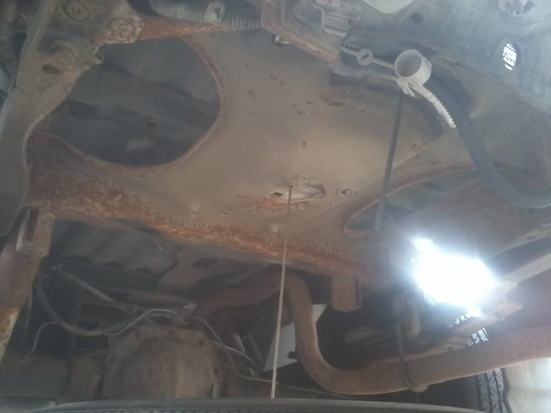

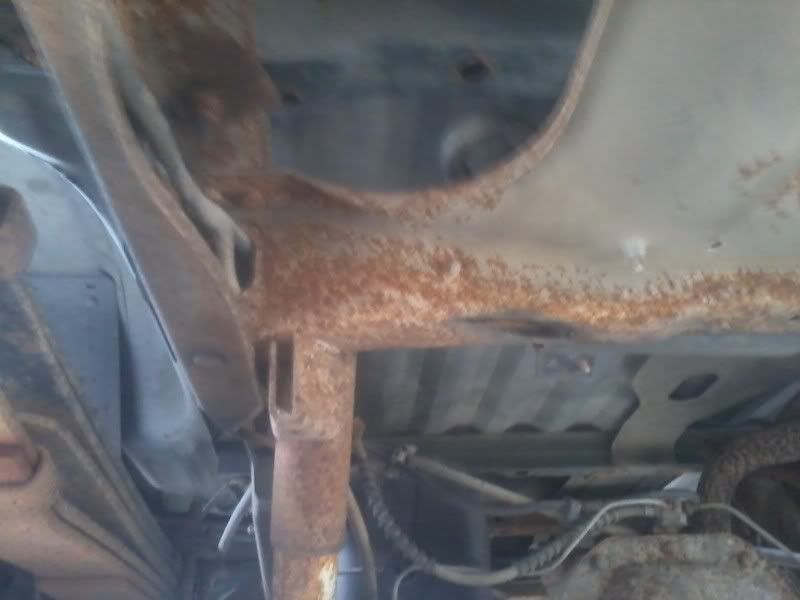

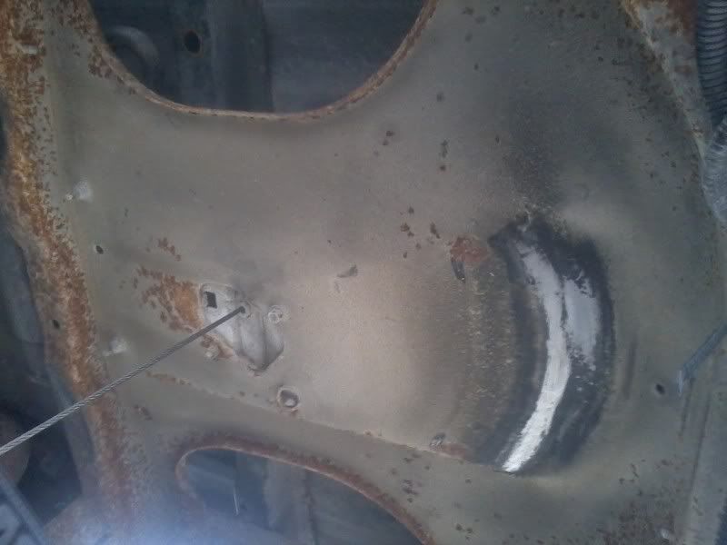

I snapped a couple pictures of the winch type mount on my 99
I see 3 rivets in each corner, but I don't see why it couldn't be mounted on an older truck.

Bduke23, I'm going to offer you the most straight up and honest answer of anyone who has posted here.
The original spare mounted with a long bolt that had an eye loop on the end of it. The point being that you used your lug wrench (that mounted behind the passenger seat) to turn the eye bolt until the built in washer clamped the wheel to the swinging bracket using one of the lug holes in the wheel.
Now, I would say, that if the hole for the bolt is rusted, to take a tap (thread chaser) and run it through the hole a few times until the hole is cleared up. Then you can and should be able to easily hand thread the eye bolt into the hole until you need to use the lug wrench to finish tightening the spare down.
If that is too much, or the hole is too far rusted out, then take a nut and weld it onto the swinging bracket so that you will have a new, clean threaded hole to stick a bolt through to hold your spare down.
Here's even another option. Go to a junkyard and pull the swinging bracket off of a pre-'97 ranger to swap over onto your pickup. They're only held on with three bolts, period, and they're not often rusted to hell.
Also, if you want a new eye bolt to hold down your spare, let me know and I'll mail you one. I know that I can get several of them for nothing, and I make frequent trips to my local yard regardless.
How did all of that sound?
