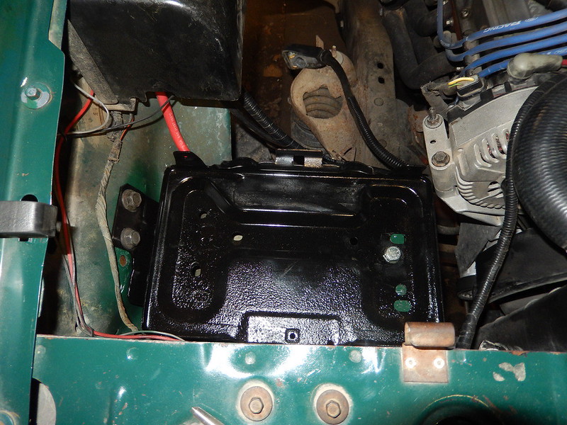

I used a brick nose fullsize battery tray in my '85. It bolts in, I just had to drill three holes and it holds a group 65 battery. I know the battery trays sit different between a first gen and a second gen (second gens are more at an angle) so I don't know how well it would fit.
