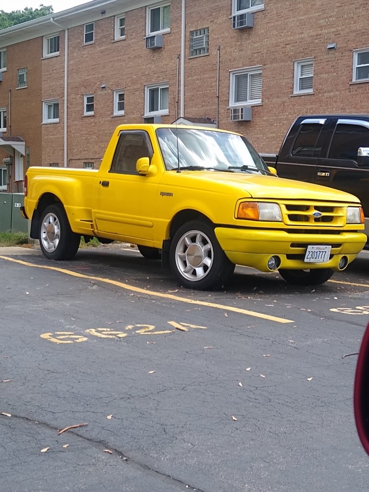

9 years later and i DO have a running, driving 2.3T Ranger!! Didn't attempt AWD like i wanted but 2wd and sticky tires is working out ok.
Still needs tuning but a basic rundown..
96 Ranger, 88 2.3t motor. OBD2 electronics with SCT Advantage calling the shots. 80mm MAF with 42# injectors, 3" exhaust, Volvo FMIC and manual boost controller. Fun truck that gets lots of attention....and itll never be finished

I think we should change your name to rip van winkle. Welcome back.(y)
