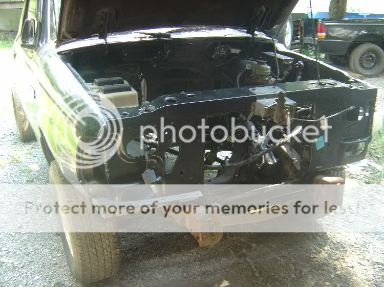

My Son decided he wanted to do another V8 Ranger, so he took this one off my hands, as I picked up another 94 that I have listed as my RAT Ranger project:
I had picked up this salvage titled 95 Ranger XLT that somebody had used as a parts truck, they used the bed & rearend.
Haven't decided if I'm gonna attempt to pull the radiator support, or just replace it............
Opted for NEW radiator support>>>
Used box:

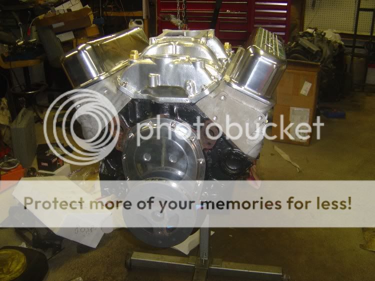

NEW motor longblocked 6-10-09:
Just got it back from frame shop Wed, but no pics yet, they put in the NEW radiator support, RF fender, & replacement hood after tweekin the frame a lil' as it was off ahead of the front crossmember just 1/2".........

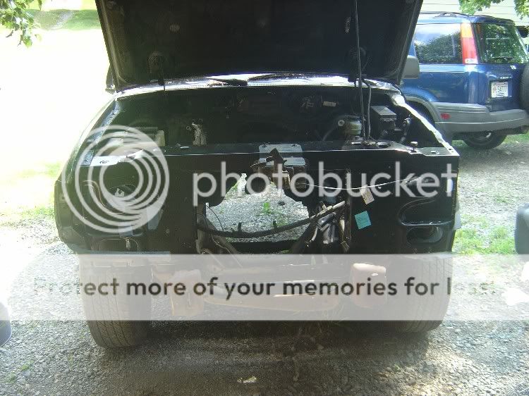

Well..............got it back from the frame shop couple weeks ago, they straightened the frame horns, installed the NEW radiator support, original RF fender & donor hood.......

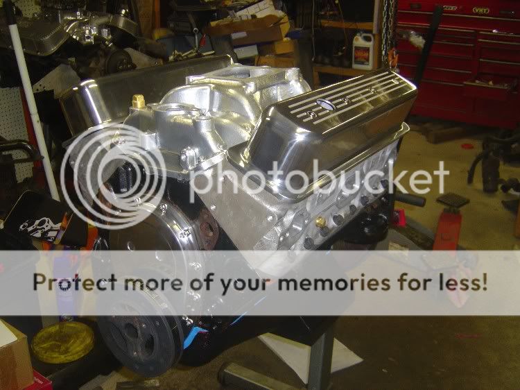

Clearer pics of motor:
As sits at the moment:

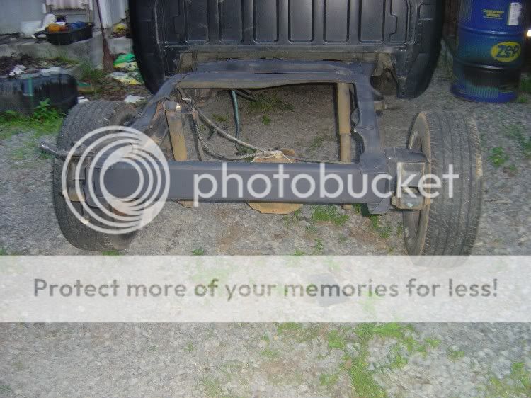

Cleaned & painted the rear frame behind the cab, cut & installed the 2x4 rectangular tubin in place of the tilted original crossmember:

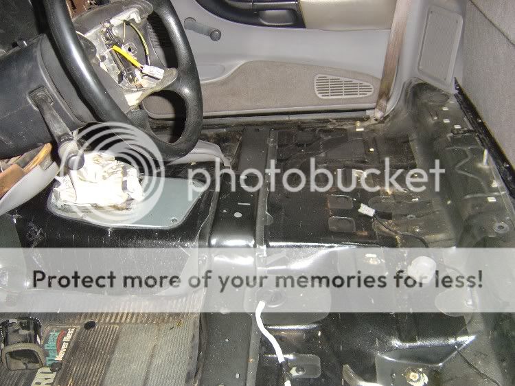

Interior stripped:
