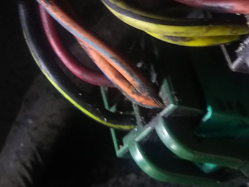

OK I jumped the ground off of the obd to the battery and the pump ran. So the issue is a ground problem, right? The pump needs to be ground by the ECU correct (its the LB/O wire that I am jumping and that goes to the ECU). Sothe problem is either the ECU or the wire from the ECU to the OBD ( or that junction before that). I am I right?
So this is what the LB/O wires look like on the back of the connector to the relay. looks like a bad connection to me - you can see the exposed wire that is not fully seated in the connector. I believe that goes to pin 22 on the ecu How would I test this? Or should I just fix it
To test it, set the multimeter to ohm, and touch the exposed wire with one lead, and the connector with the other.
To fix that, you might be able to pull the pin out from the connector and carefully pry the tabs open, reseat it, and reinstall, but I've never tried. Otherwise I'd get a box of good heat shrink butt connectors, snip the intact wire 3-4" away from the connector, and connect them all together. Like (two wires)>[butt connector]-(single wire to relay)
Have you triple checked all your chassis grounds? for grins try running a temp ground wire from the ECM to the battery, that would prove/disprove a chassis ground issue.
If there's continuity at the relay plug, and an extra ground doesn't fix it, I'd say its the ECM
OK, I just pulled that connector pin out and I ran a voltmeter between the battery negative and that wire (both on the exposed wire and various parts of the connector pin. Got no resitance. That tells me the ground is good.
I'll try the extra ground thing, but all signs point to ECM I think.
