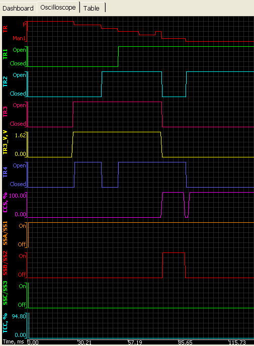

I've done some testing with FORScan and I've become somewhat suspicious of a couple of bits of information in that very useful ATRA attachment in post #4 by @Transman304. On my 2004 4.0L 4WD Ranger, FORScan shows this:
**SOLVED** 5R55E No/Weak Reverse, 1st Engine Braking Works
This shows me, with engine running, shifting from P -> R -> N -> D -> 2 -> 1, with an additional step when in 'D' of turning O/D off then back on with the switch at the end of the gear selector lever (an act which had no effect at all on any of the monitored PIDs [EDIT: other than the 'TR' PID], BTW). The top red "TR" PID line shows the point in time where the gear selector lever was moved or the "O/D OFF" switch was activated, yielding 8 distinct "zones".
In 'R'everse, shift solenoids 1-4 (where "SS4" = "CCS") on my truck are 1,0,0,0 (or On, Off, Off, Off) but page 8 of that ATRA document shows that they should be 1,0,0,1!
Furthermore, in '2' (manual 2nd gear), shift solenoids 1-4 on my truck are 1,1,0,1 but that ATRA document shows that they should be 1,0,0,1!
But my truck's behavior matches a Sonnax PDF document for their '4R44E-5R55E-ZIP' kit and seems to also match the ATSG manual. So I'm starting to think that the ATRA document is wrong in 2 spots in that table.

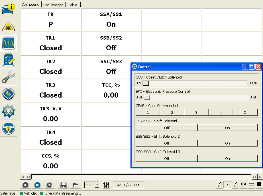

Also, although it might be too late to be useful for now and I'm not sure if FORScan Lite offers this, something I forgot to mention is that FORScan for Windows allows control of various PCM "things", including transmission-related things.
I've used this in the past to control various innocent things like the dome light or the horn, but I've never had the guts to try controlling transmission-related items. :eek:
FWIW, here's what it looks like under FORScan for Windows (version 2.3.35-beta) with all of the transmission-related items selected for control:

Very interesting. I'm pretty sure Lite doesn't have the feature to control the solenoids, but I can imagine it'd be handy to be able to manually control those parameters to help diagnosis. Kinda what I was doing when unplugging the "brain" to force maximum line pressure and get reverse to work, just a lot less crude.

This is getting OT, so I won't get too deeply into it, but I had noticed the oddity on these 5RxxE transmissions over 2 years ago, when I was monitoring some transmission-related PIDs and noticed that my 2004 Ranger never reported (via Mode $22 PID $11B3, "Transmission Gear Status") being in 2nd gear (going 1 -> 3 -> 4 -> 5 -> 4 -> 1). So I've known about this "funky" 2nd gear thing for a while. It's not too bad once you're aware of it, but it was initially a surprise for me. It's all the more reason why I want to understand and document how this transmission works while (for me) it's still working correctly.
Having said that, I still think that the 2 cases that I pointed out above are mistakes in the ATRA manual. I was hoping Transman304 might have had something to say about it, because it seemed rather odd to me.
