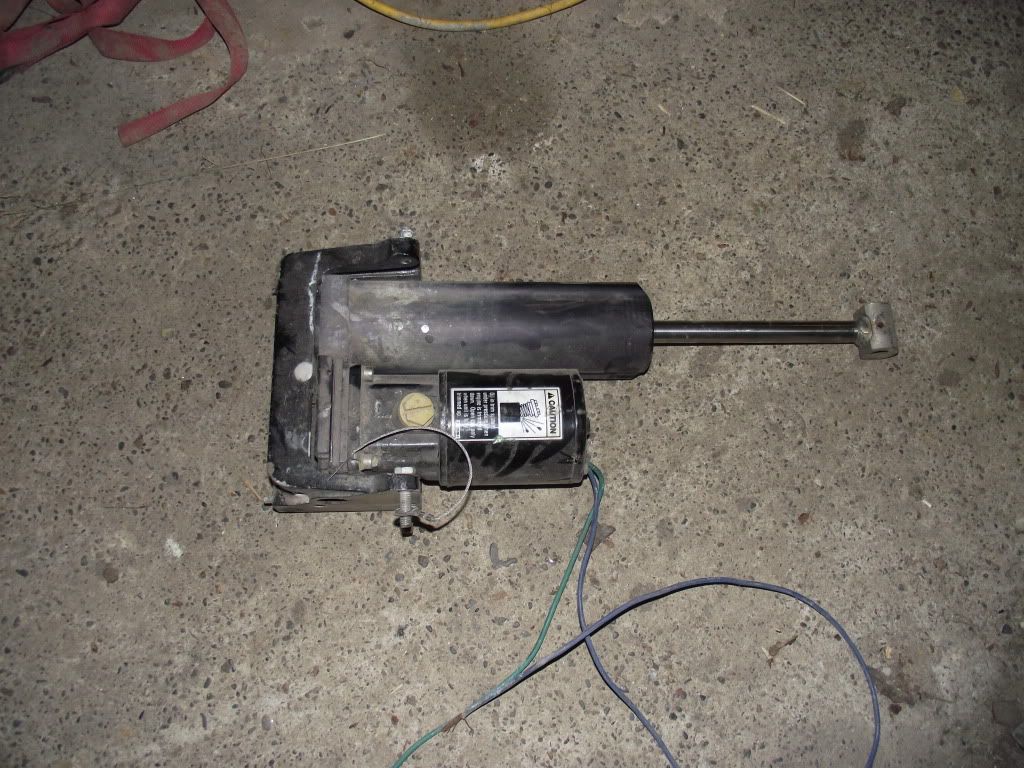

i don't know what the supply of used outboard motors is like there,but i have a power tilt unit from a 2000 merc 60hp that is just a ram and a pump-no trim buttons.it'll easilly lift the front of a fullsize truck off the ground,and would handle your plow easilly.
i bought the whole motor with a blown piston for $50.if you can find something like this,it would work.the ram is bi-directional,too.

Linear actuator. What I was thinking, I just had no idea where one could be salvaged from, lol.

That cylinder rod looks to be about 3/4" diameter. Just curious as to what kind of plow you have with power angle rams that small? My light weight Meyer plow for my Ranger has 1.5".

ok,took another look at the plow(arctic,bolts to my f350)and i owe you an apology-or at least a clarification.the cylinder on the outboard ram is bigger than on the plow,but the rod is smaller.
the rams on the plow are single acting,with 1 1/2'' rods.the outboard ram is double acting with a 3/4'' rod.
the cylinders on the plow are 1 1/2'' bore,the outboard unit is 2'' bore.
it would be a matter of speculation on my part or yours as to whether it would hold up-at least untill someone tries it.:icon_thumby:
I appreciate the info, thanks. Something like pictured here would be great. I'm looking for something that I could just wire to the battery and to another snowbear plow switch in my dash and it should work great. The hard part would be moding my plow to make this work and I don't know if this would be strong enough. If I get sand and salt on it, will it jam? Will it leak? Is it hydraulic? I guess I would just want to keep it clean and waxed?
it's hydraulic.it's also part of an outboard motor,so it's designed to be immersed in salt water for it's entire operational life.sand would not be an issue any more than any other hydraulic cylinder.maybe less-most are not sealed as well as marine equipment.
it's powerfull enough to lift the front of an f350 4x4 off the ground without straining-so at least 4000lbs,and it's bi-directional.
the size of the ram shaft could be an issue,that is hard to say.my guess is it would probably be fine,but the only way to know for sure would be to try it.if my plow was not already equiped with steer rams,i'd try it.but then,i already have the parts here,so i've got nothing to lose.you'd need to track it down and buy it,so there's more risk there.

and this is not a linear actuator.those are mechanical drive systems-generally a motor turning a screw.this one has a motor driven hydraulic pump that feeds pressure to a hydraulic cylinder.
what's the difference?
power.
most linear actuators have power ratings in the range of hundreds of pounds.
hydraulic systems such as this have power ratings in the range of thousands of pounds.
this particular system has two wires to operate it,they have their polarity reversed to change directions,as with a power window motor.or a linear actuator.

I stand corrected.
