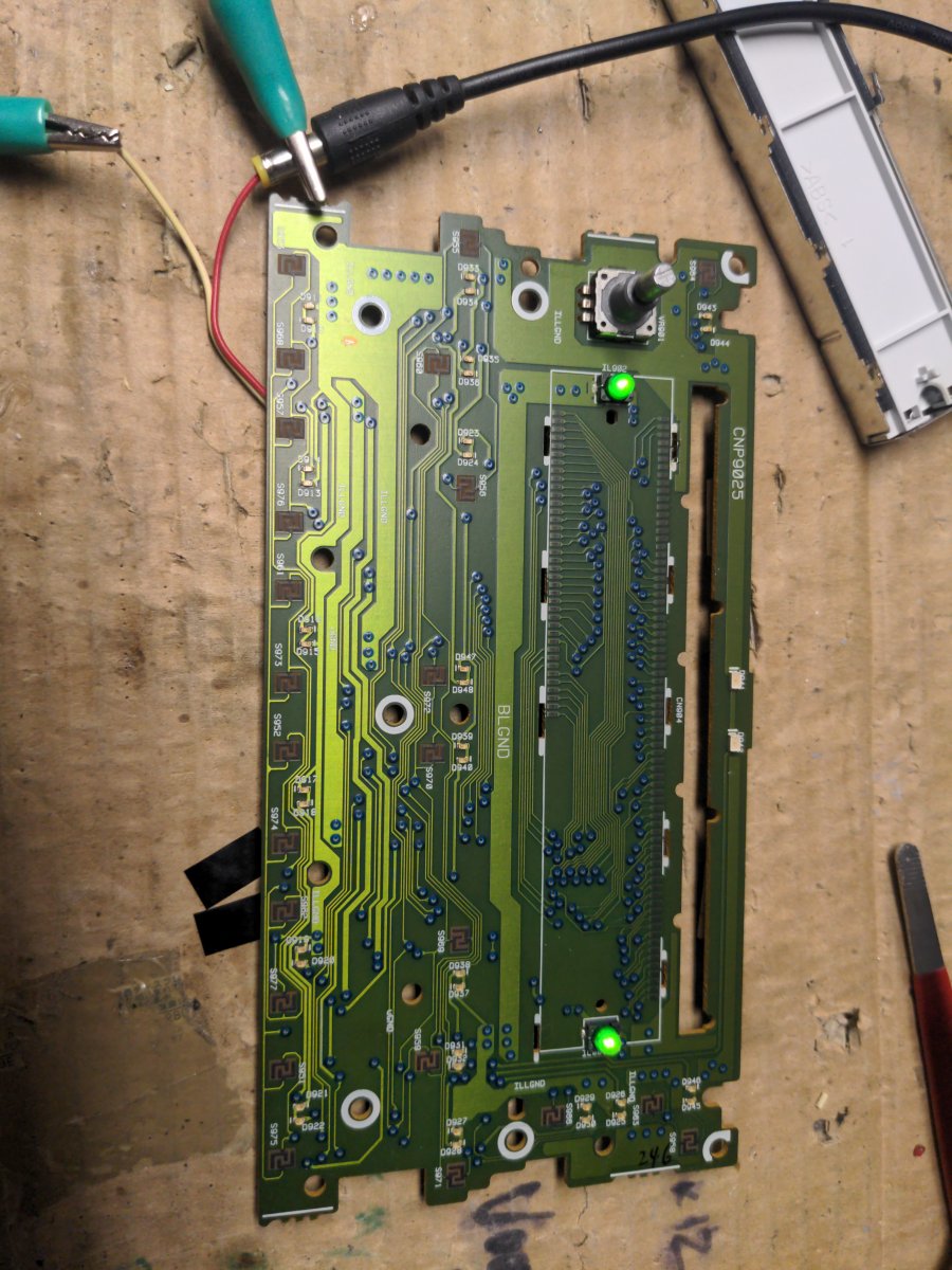

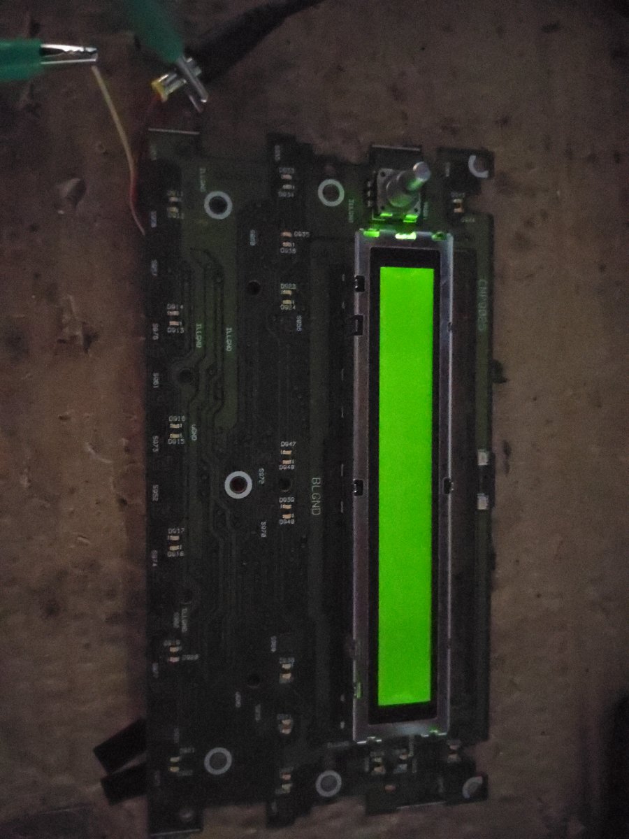

I need to tear into this today but I'm just curious if anyone's seen this before - when I can't find a schematic I always like to look for pattern failures before I start. I have a single disc factory radio out of a 2007 (I think) which I swapped in to my '05 to get the aux input. It works fine except for one fault. When I first turn on the day backlighting, the LCD is backlit the way you'd expect and is perfectly legible. Over a period of 2-3 minutes, that one backlight slooowly fades out to the point where it's impossible to read. All other lights in the radio are fine and normally I'd just suspect a bulb (if it even is a bulb)- is just the slow fade out that has me wondering. I expect it'll be something like failing LED and/or something heat related.
Really just wondering if anyone's seen this or if it's totally random.
That's a strange one. I woukd expect it to be a problem within the radio itself. If it was anythung else, all the lights on that circuit should act the same way. A led usually just flat out fails - works one moment and then quits permanently. So I wouldn't thjnk it's a failing LED. Without knowing the internal cuecuitry of the radio unit, it will be extremely difficult to fix.
Agreed, it's a puzzler. And to be clear, I would't really suspect a LED , but more some other component that drives it. Would Ford be so clever as to use incandescent bulbs for all the other backlights but a PWM circuit to drive a LED for dimming? I really hope not but I've learned to expect surprises from engineers. 😀
It's the slow, steady linear fade out that makes me think either heat or power supply. Should be fun.
