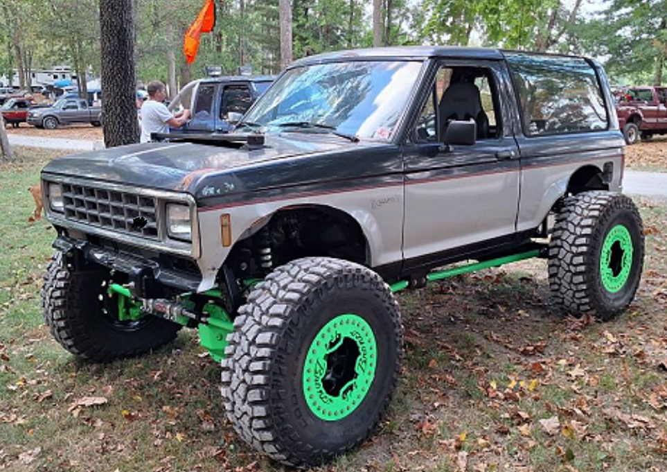

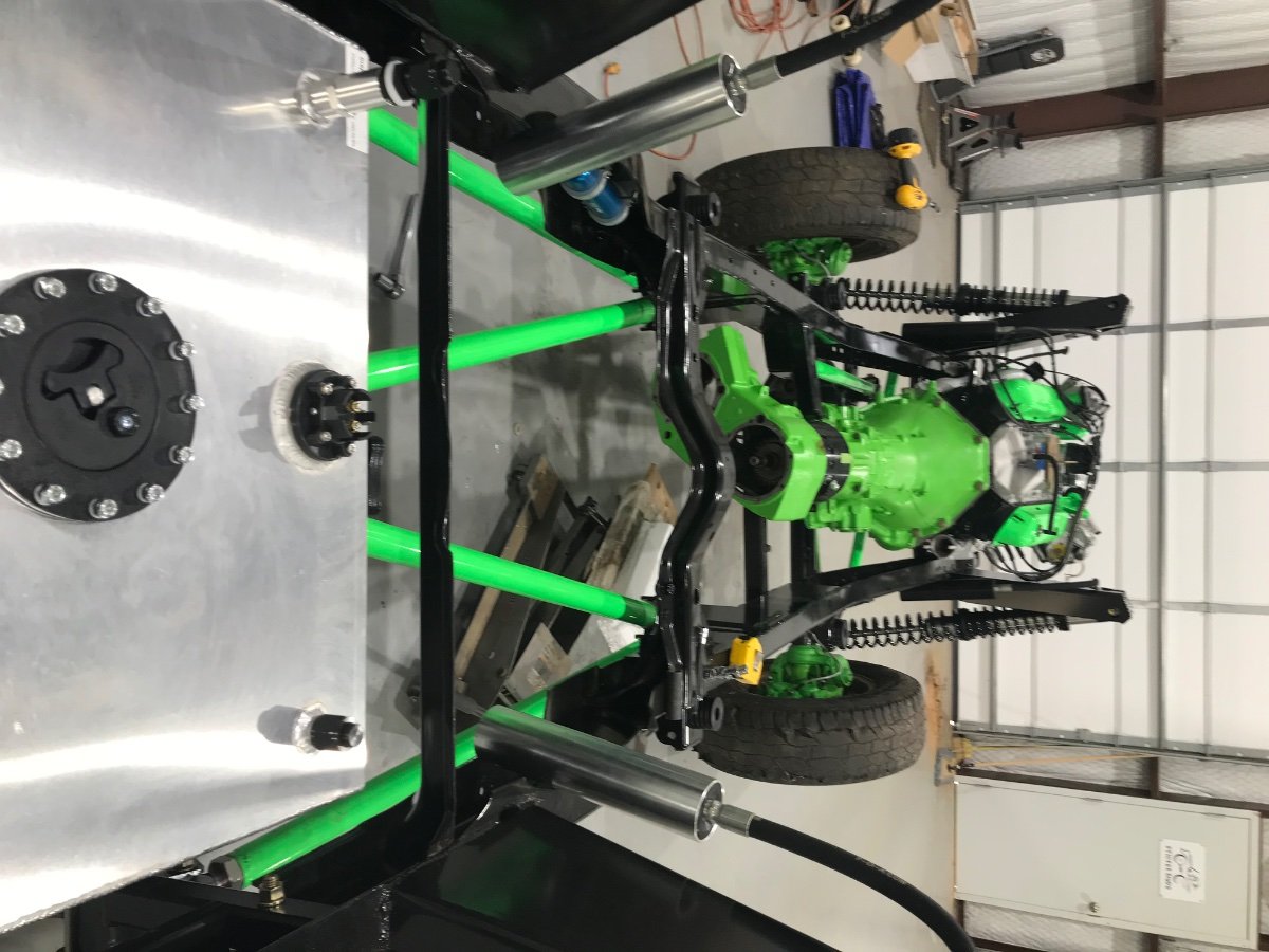

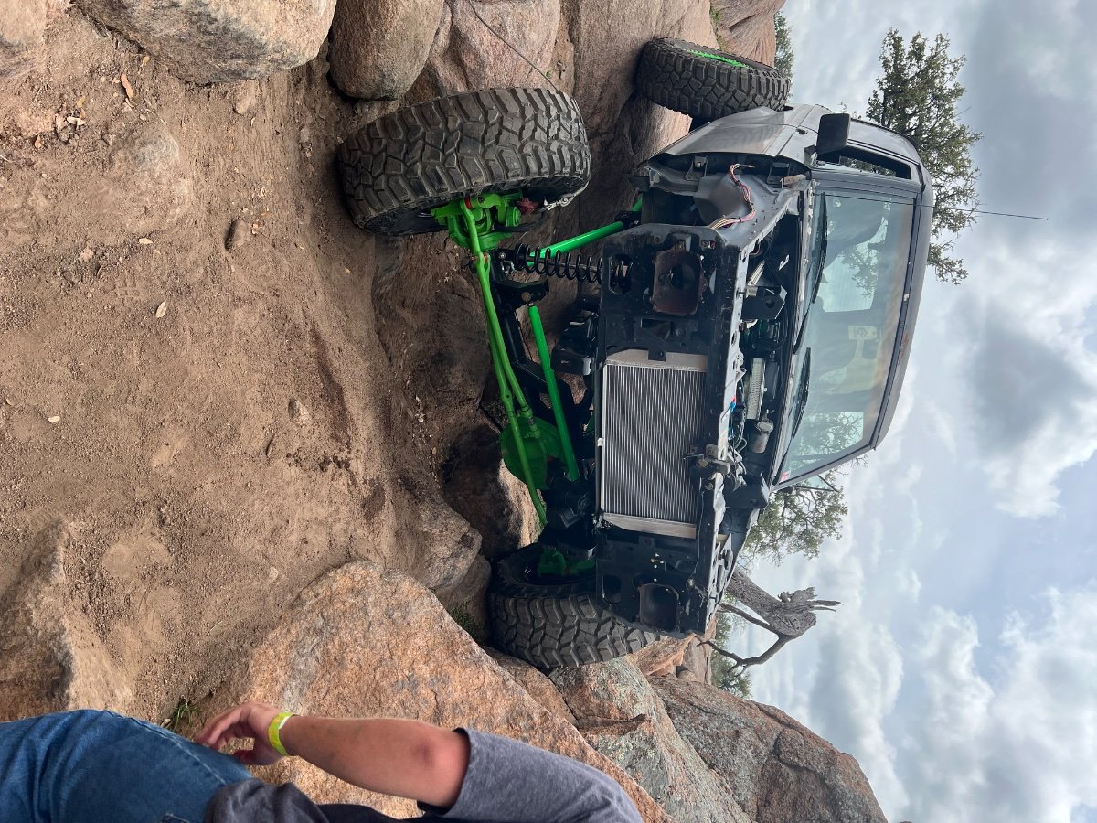

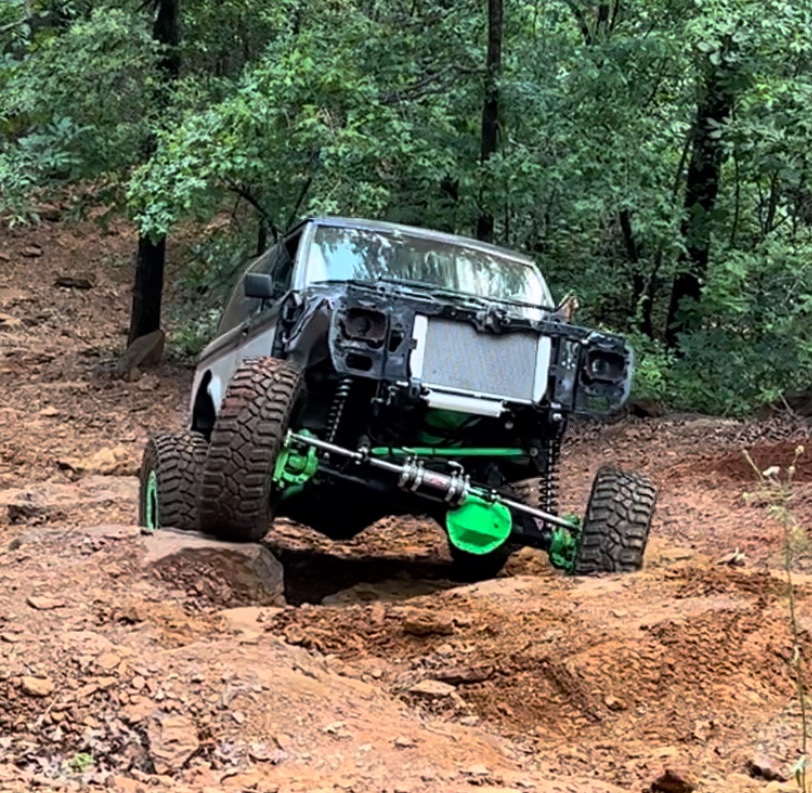

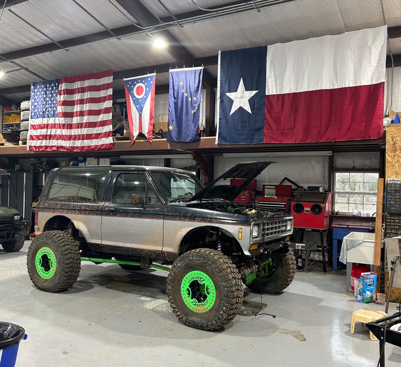

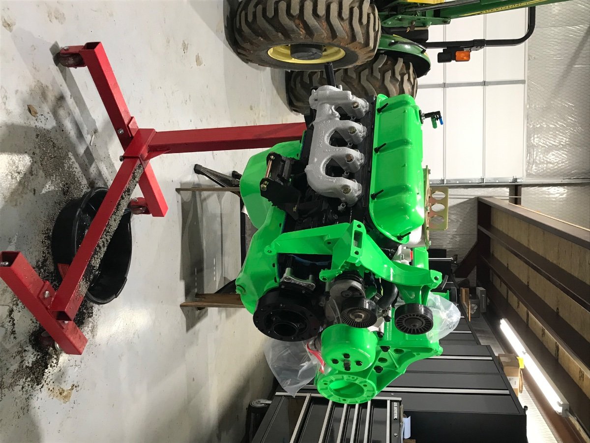

Not a ranger, but…….y’all have always made me feel welcome.
I keep saying this is my spare parts pile. Started as a 1988 2 wheel drive BII.
5.0L stock rebuilt roller with Holley Sniper throttle body, ignition and digital dash.
Backed by a rebuilt C6 with a reverse manual valve body. Behind that is a Northwest Fab doubler in front of a NP 205. I feel it’s pretty much bulletproof.
Stretched the wheel base 4 inches up front and 8 in the rear with F-O-A 14 inch coilovers. The longest arms I could fit on a 4-link rear and 3 link front.
It rides on Dodge AAM’s with ARB lockers turning 3.73 gears on 37 inch bead locked Coopers. Steered with a full hydraulic PSC ram.
All while keeping the AC!!! It is a Texas rig after all.
9.5 warn winch up front when it just won’t go anymore.
Still tweaking it.
Changes to come……
1. A more snug fuel tank.
2. Cleaner enclosures for the rear shock mounts.
3. Snubbers on both axles.
Still playing with it, it’s proving to be pretty formidable and forgiving on the rocks.
Pics to come.

Sorry, it rotated some of the images……..and I’m technologically challenged and can’t fix it.
It's something with the forum software since the upgrade. We are all still trying to figure out the quirks. So, it's not just you.

If you use the Attach Files button at the bottom, it might not post it correctly. For some reason it doesn't read the EXIF orientation values in the image, but if you use the insert image button at the top, it should post it the right way.

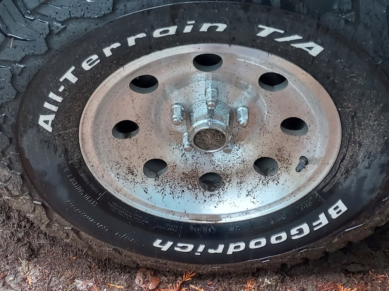

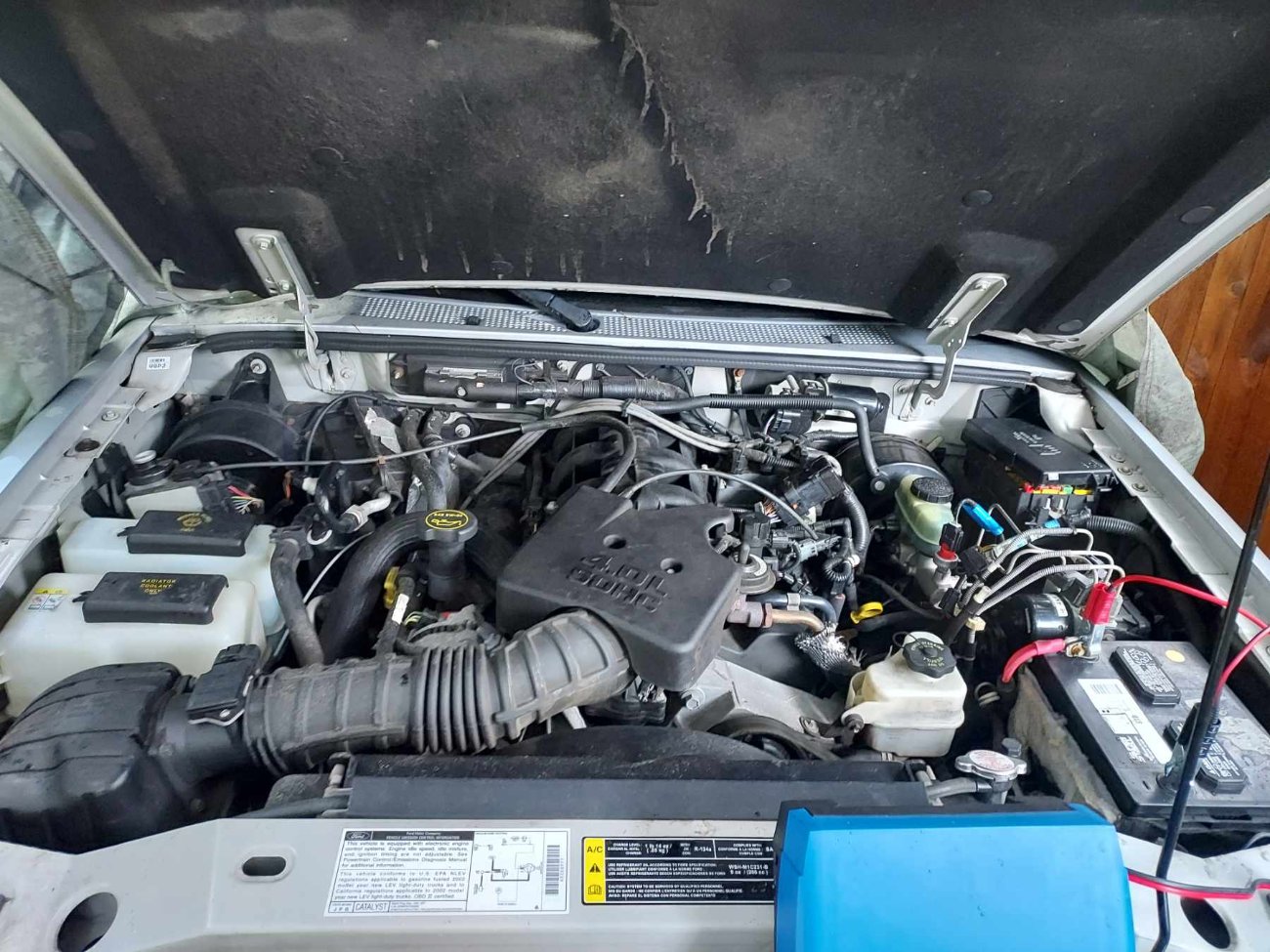

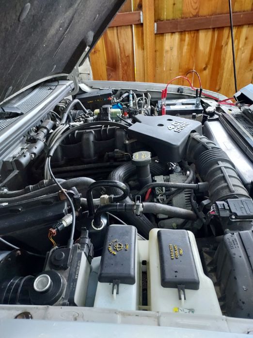

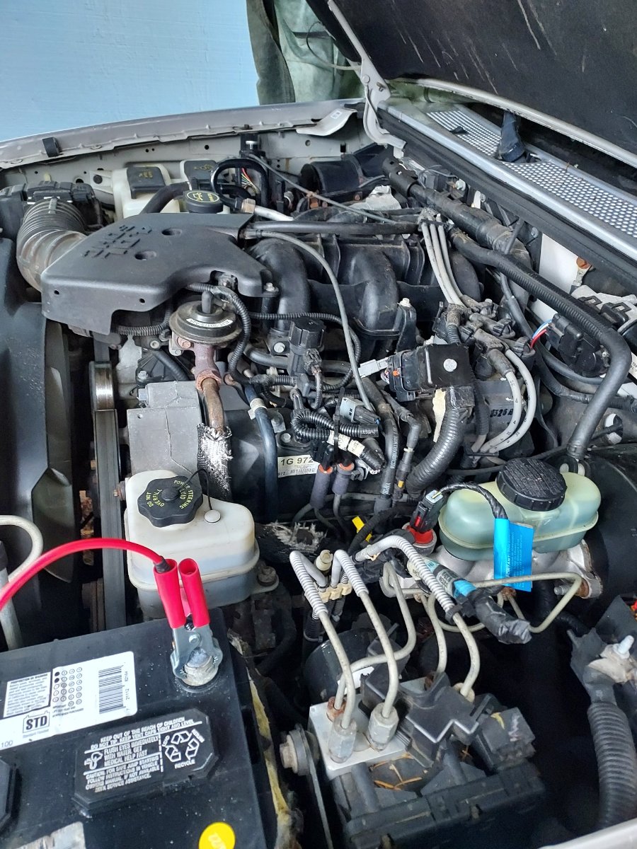

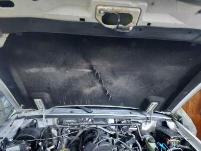

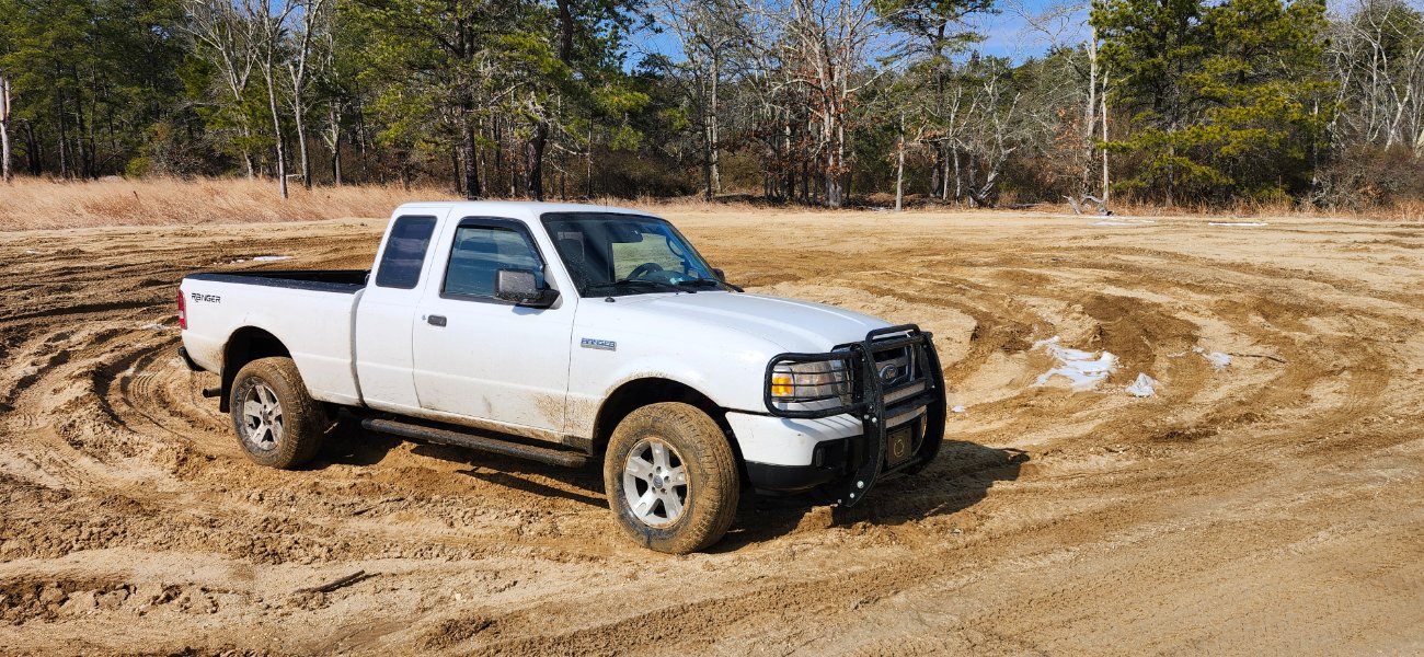

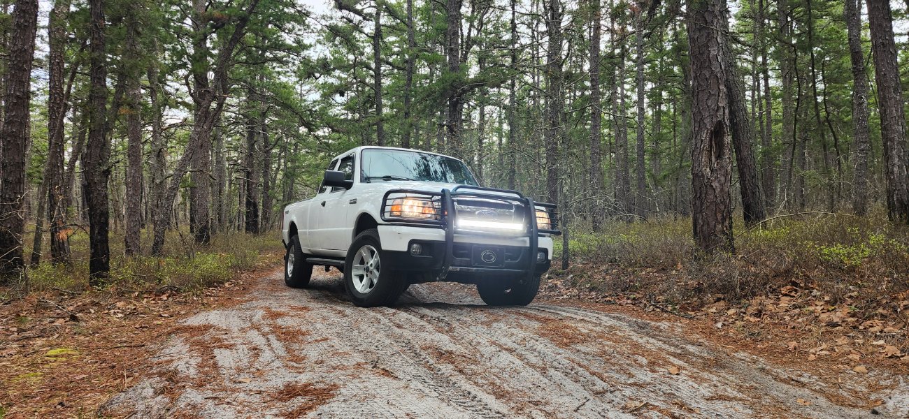

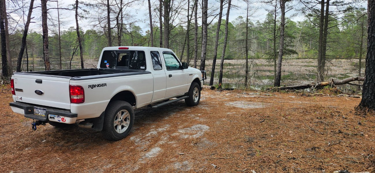

2002 Ford Ranger Fx4 Off Road 4.0 v6 245 cid 207 hp - What makes my ranger a good off roader is the 31 inch all terrain tires with 3 skid plates that i have tightened the bolts on under neath my truck in the front, middle, rear and for being off road those stainless steel tow hooks help alot and are cool and my rangers compact size is great for off roading and my ranger is cool =)
I have never gone off roading in my ranger but i have driven through snow and that was fun and enjoyable. I have thought of putting a lift kit on my ranger like a 8 inch with 35 inch tires but then i always think to myself im a stock truck type of guy for the most part so i will leave my ranger at its stock height with its stock size tires. My 4wd high and low work good the way my 4wd is supposed to so thats awesome.
What i would do different today if i could wave a magic wand is for my ranger to have no tinted windows and be a different exterior color. And a locking tail gate would be nice to have.

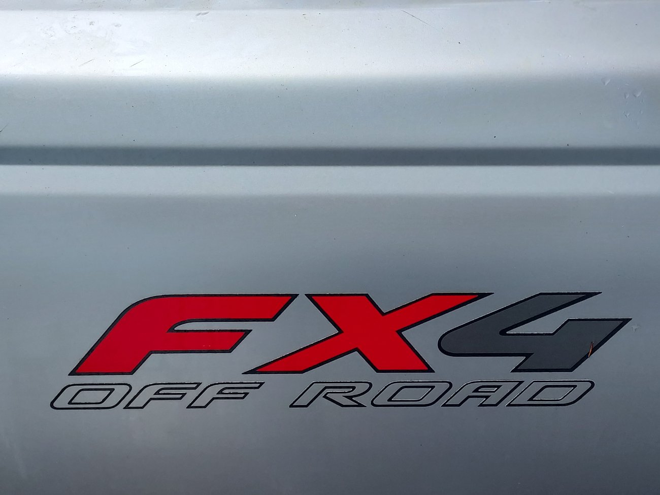

People have asked me when im out in the past they have said do you want to sell your truck. I bought my ranger with my own money in the early part of december 2022 for $10,500 then i put $4,500 more into my ranger so now I have $14,500 into my ranger. are the stainless steel tow hooks bigger than the non stainless steel tow hooks ? Was there ever stainless steel tow hooks for the rear ? Does anyone know why the FX in my fx4 off road decal is red ? Why did ford not put a under hood light on ? when it would be nice to have installed. The ford f-150 has a under hood light and thats a full size truck but my compact ranger does not have a under hood light and its a compact truck so ford did not make much sense at all to me when they left the under hood light off and it was not even offered as a option. Whos idea was it to have 8 holes in my rims and whats advantage of 8 holes in my rims ?
