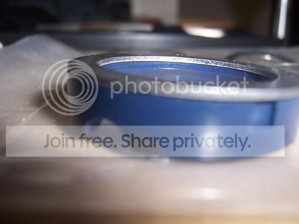

Got my bushings in the mail today and installed them tonight. Had a bit of a surprise though - the kit didn't come with the "flat" and "wavy" washers everyone talks about (and that were installed before I replaced them). Instead, it came with just 2 flat washers that were a bit thicker:

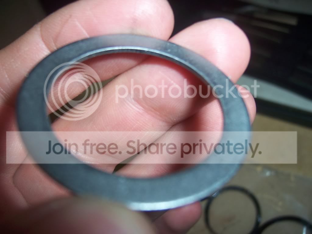

I was puzzled at first, and thought I'd have to wait until I could get new washers from a dealer (the ones I pulled out of the truck are destroyed), but soon discovered that one of the new larger flat washers was a perfect replacement for the one flat/one wavy combination:
So, I put in a new washer, lower bushing, upper bushing, new washer, new cap, and put it all back together. Not the miracle fix I was hoping for, but does feel much smoother now. I also found that it looks like the 1st/2nd return spring is there, it's just shortened/jammed to the point where it doesn't do much good anymore. I monkeyed with it some, but I think it will have to wait until a tranny rebuild is needed.
