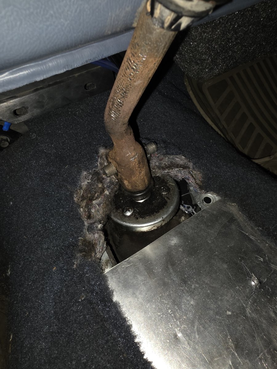

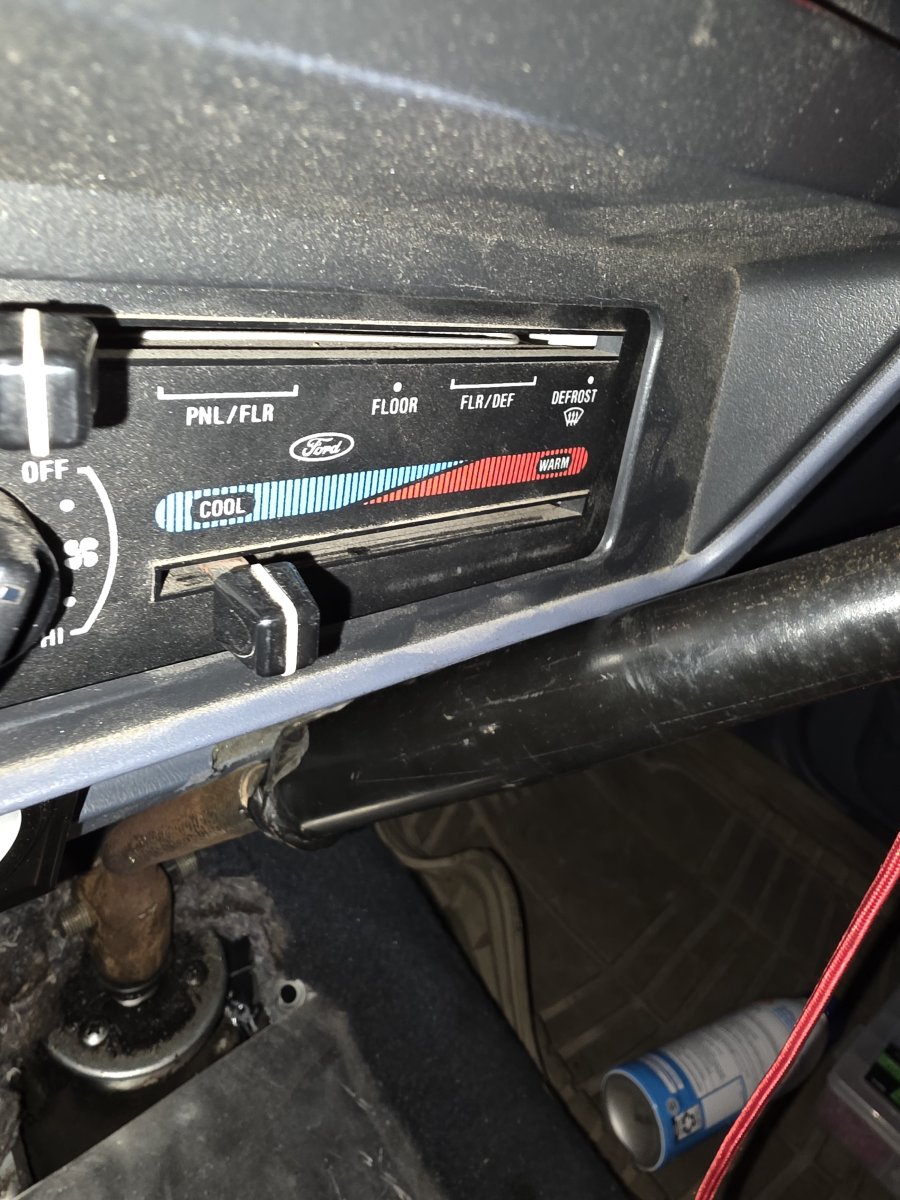

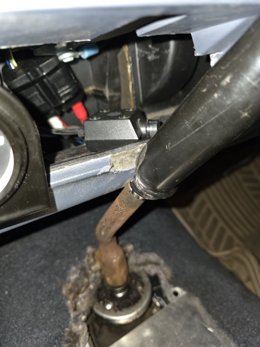

I have noticed that thw clearance after the swap is no where near close to what I used to be, to the point where my 5th gear actually makes contact with the plastic on the dash. Is there any efective way to bent the arm backwards I tried using heat and a vice but cant get it to budge much. Or better yet is there any shift rod from any other vehicle that would give me a better angle?

The shift rod it too close to the dash so when I shift into the top gears it hits, ive tryws shaving some material away but it's still not enough. I have also tried to bend the rod but because it is is cast iron it doesn't like to bend much. It is an m5od

cut and weld
it looks like you have the early closest to the dash position.
if it is the early farthest forward
you can swap the whole top from a mid mount....that will give a bit more room
the late late a style is all the way back and perfect for the ranger but wears a bit quicker
