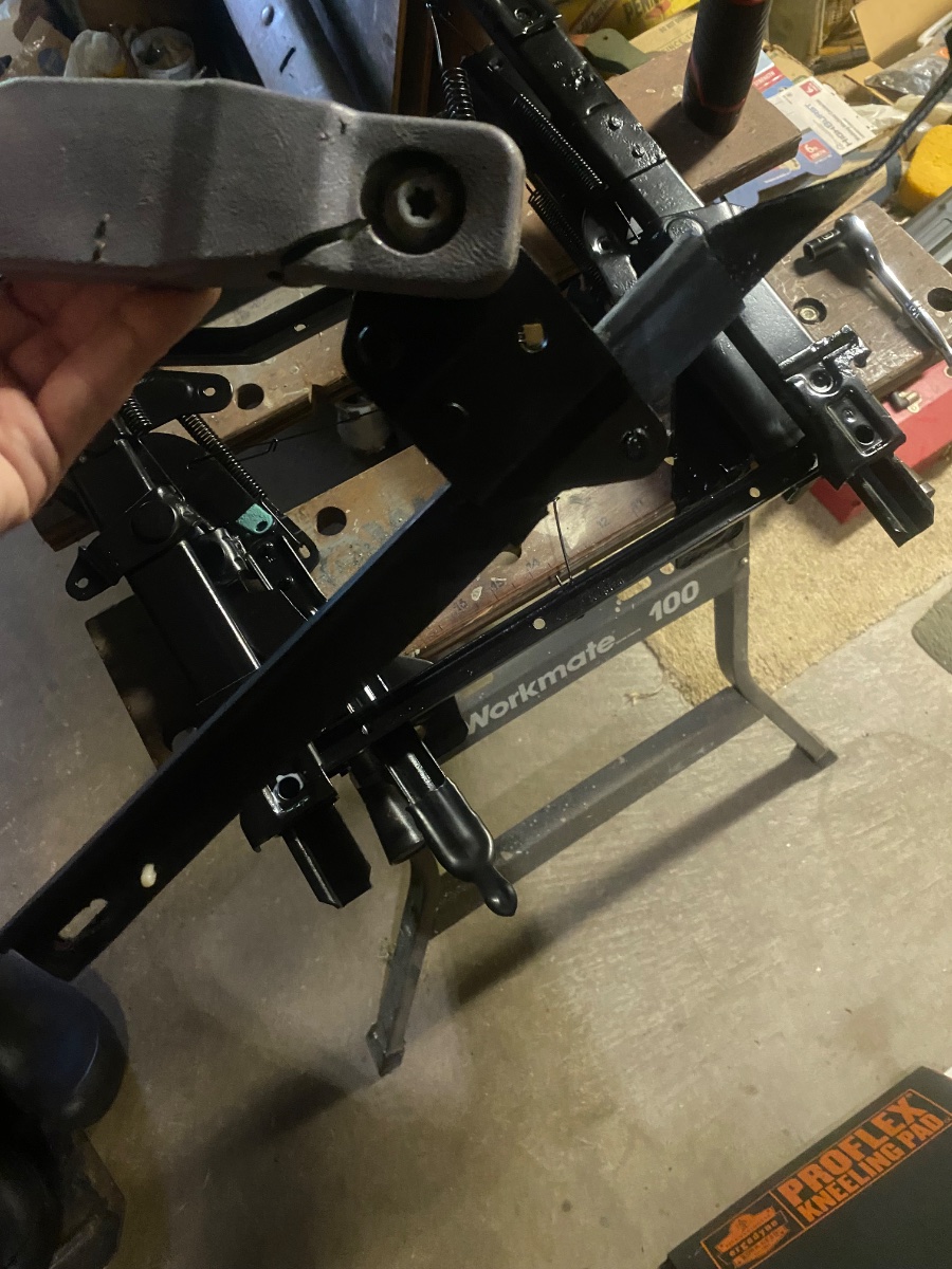

I had to clean and fix up the seat tracks in my 1993 extended cab. I was wondering if these seat belts are supposed to slide freely along the bracket? The metal underneath the plastic coating is rusted causing the plastic to swell. Is there a way to fix this without getting new seatbelt brackets?!

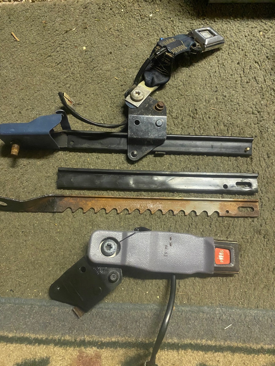

Think I figured it out. The only thing is the plastic that it slides on is all swollen and won’t go back to original shape. I wonder if I can just buy the plastic sleeve?
Tried to use the one off my 1987 ranger but it’s 3/4” shorter and doesn’t have the slotted bolt hole in the front

Yes. It's supposed to slide.

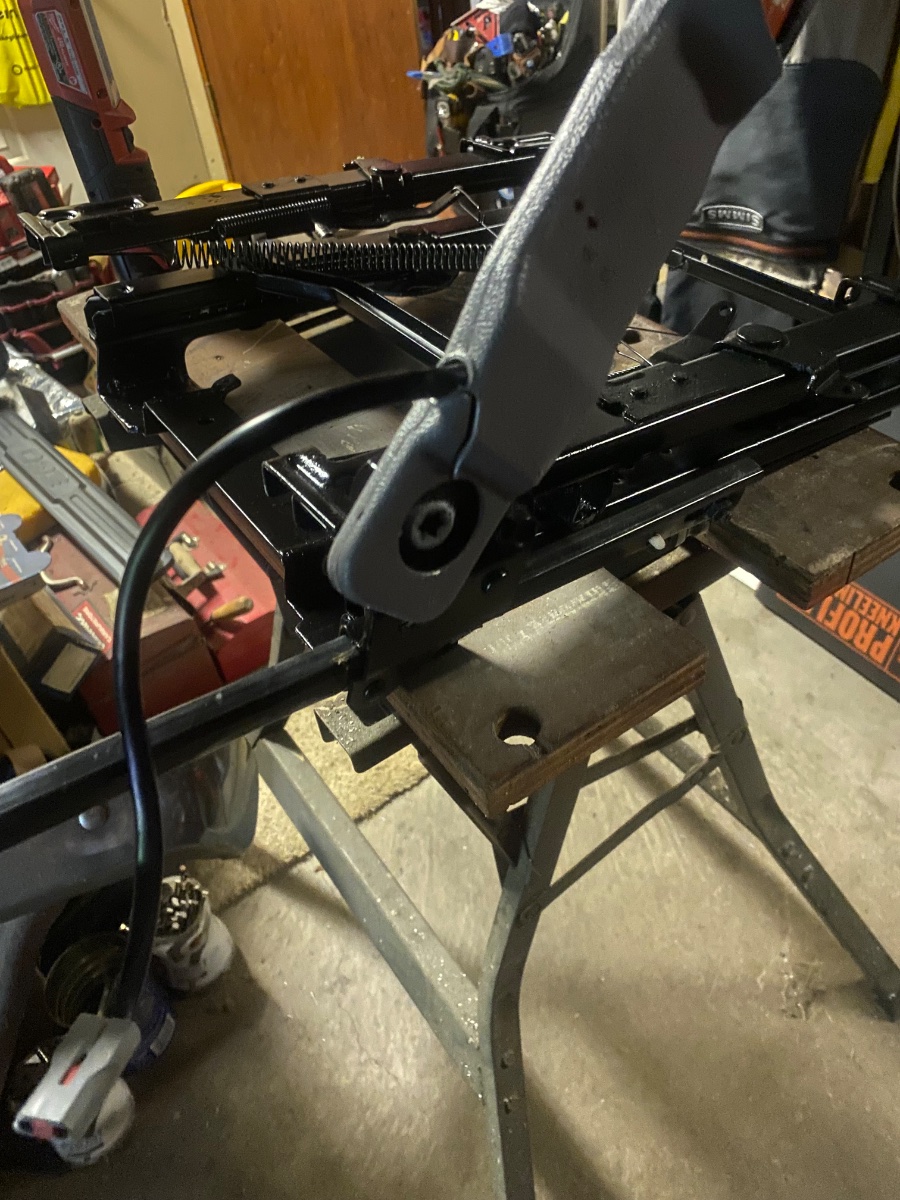

I was able to get it back in shape by soaking it in some hot water for a couple minutes, and clamping it between some blocks. Then I dumped cold water on it to lock in the shape. Got it sliding pretty decent again. Now I just have to clean and paint.
