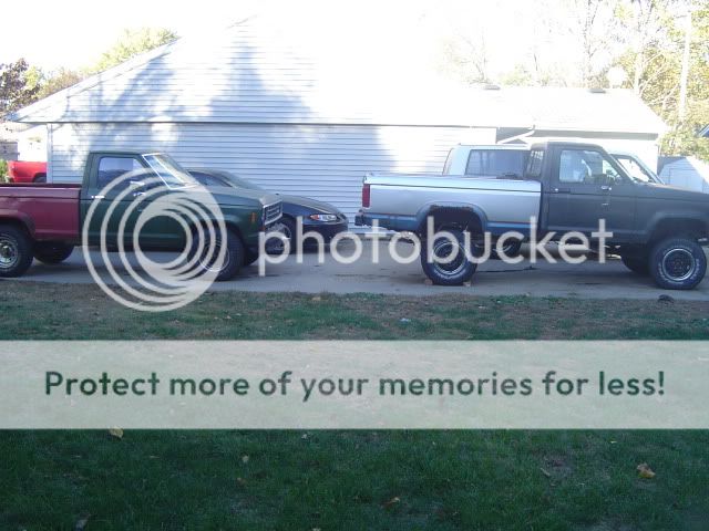

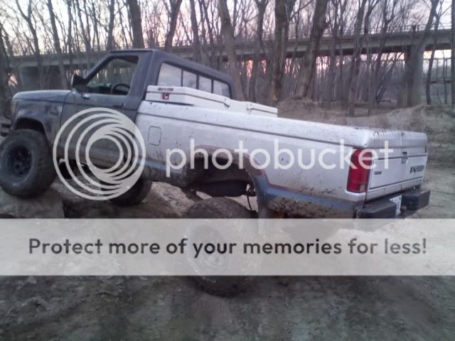

Heres my truck right after my D30 SAS with 6.5 inch XJ lift coils up front rated at 180lbs and Chevy 3/4 ton 63 inch leaves in the rear with the belltech 6400 shackles and factory lift block. Factory coil buckets were used. Gave me 5 inches of lift in the front and 6 in the rear
My dads old truck is 100% factory, rear one, and mine is the front one.
