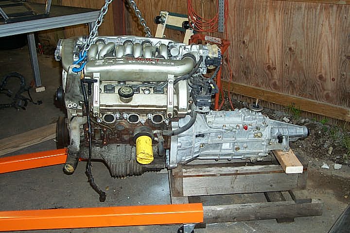

Yes. I saw a pic on here, I think it was posted by PlumCrazy, that was a 3.0 M5OD bolted to a DOHC 3.0.
Hmm ill look it up
I don't think I've ever seen a 3.0 duratec bolted to an M5OD. You weren't thinking of this pic were you?]
That's a 3.0 DOHC but not a duratec.
An SHO v6 out of a Taurus. Either a 3.0 or 3.2. Same bellhousing bolt pattern as the rangers 3.0.
