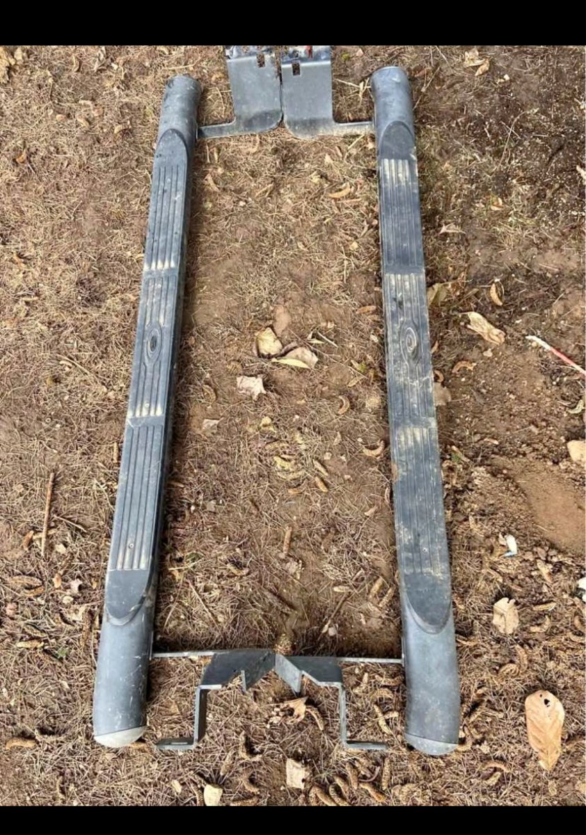

This is what he's selling...came with/off his 2001 Extended Cab.
  • "Running board" Interchangeability
Learn something new all the time. Those do appear to bolt to the floor pan in the cab. Maybe all of the ones I've been around were aftermarket, can't say I looked close enough to tell or would remember at this point.
In that case I think the guys above would be on point. They wouldn't interfere with rear door function either way.
This one is a Ford marked board that came with the truck when bought new.
I kinda remember some YT vid where board mounted to cab.
I'll get it in next couple days and report back.

Wow...thanks to all! Been out of town and haven't kept up with posts...sorry about that! Yes, Ford only shows one type of board for the '98s and its brackets do not match those '07 boards let alone not having the holes in the frame that the '07s use. Back to the drawing board! 8(
