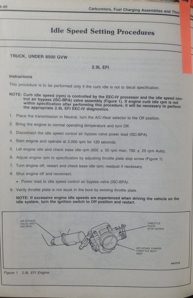

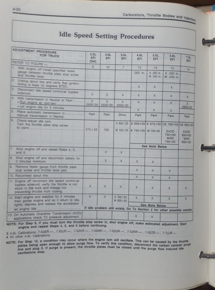

Here's some info if you want to reset the idle screw.

Ok. Quick update.
Did not do the procedure listed above, but did crank down on the throttle plate. Definitely idled lower, ran through warmup cycle mostly fine and settled in about 1k before I cycled through gears. Drove it around the block, ran ok. Felt underpowered, had very different engine note. Turned truck off, grabbed dog to take to park, attempted to turn back on and found it wouldn't stay running. 3 times fired up, 3 times immediate stall after turning over. Opened screw a little more (didnt test voltage at TPS) and found truck would stay running. Ran fine, ish. not sure if computer needs 100 miles or so to digest the change? Stinks like eggs. Think new injectors are absolute hoses. Also, I fear I have a non-motorcraft IAC and it might be throwing off the mix. MAP sensor looks non-rotorcraft as well.

SOmething sounds definitely off if adjusting that plate stop screw has such a major impact, that should not be. Sounds like the IAC is plugged up/not functioning or what have you. Also, your throttle position sensor may be off/broken?
I just applied the above procedure and it did work as described. I had too high an idle with the IAC disconnected and after running at 2,000 rpm for two minutes. Adjusted down, stopped engine, turned back on, adjusted just a bit more. Stopped engine, reconnected the plug to the IAC and now runs just like it should according to the emissions decal (around 800 in neutral, almost the same in drive). My TPS gives off .98 volt at idle, 4.7 at full throttle (backprobing the middle pin, negative to ground), so that seems good also.

Actually my idling problem seems solved, after I applied the adjustment procedure for the throttle body 'butterfly valve adjustment crew'. Nice and even idle, no more faltering or almost-stalling. I now have a different problem (it's always something it seems) with the truck just not starting at all on colder mornings. (Relative term here in Southern California). Twice now this week, it refused to start (starter cranking and cranking, but no start) and I could tell it was the fuel pump just not turning on as it should, when turning the key to 'ignition' for those couple seconds to build pressure - nothing at all. After it warms up in ambient temperature, it starts no problem and will restart all day long. I suspect one of the relays, under the power distribution box (either for the EEC/ECU or the fuel pump relay) OR the ignition module - although I replaced all three not that long ago except the fuel pump relay - as that looked almost new when I first took a look at it. 'Bad almost out of the box' may apply here. Off to order me a fuel pump relay and ignition module first, see if that's it. (Previous owner also replaced the fuel pump inside the tank - hoping that's not gone bad within 2 years so I don't have to drop the tank etc).
